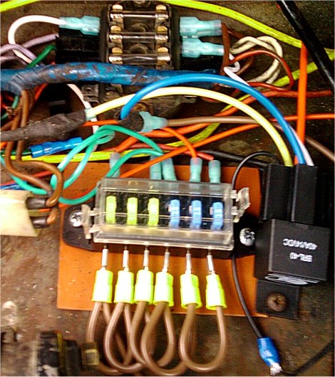

I also swapped in my spare Midget fuse block for the old one and couldn't get voltage to go through it. Went across the street to True Value and bought a .270 rifle bore brush, chucked it up in my drill and went to work on the contacts.
Now it's working great!
Here is a picture of my new fuse block.
It is strictly providing switched battery + to things.
The reddish pad under the new fuse block is 1/8" rubber.
The brown side is battery positive that is fused before it feeds this box. The output side feeds things like my electric fan, heater fan, cigar lighter.
The 40amp relay trips when the key is turned on, providing battery + to the new fuse block. Now very little current passes through the ignition switch.

I've got a little wire that's broken and don't know what it is for.
You can barely see it in the picture above - upper left side just below the blue wrapped bundle of wires. It's brown with a purple stripe.
Anyone know?
