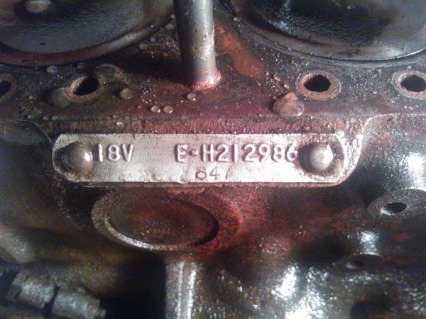

As for engine year, look on the ID plate on the block between #2 and #3 cylinders, near the head.

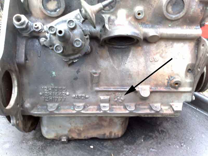

If that's missing, there's a "clock" located on the same side of the block, near the oil pan that can be read to determine date of build.

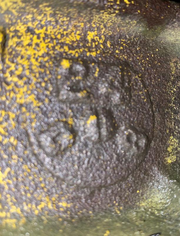

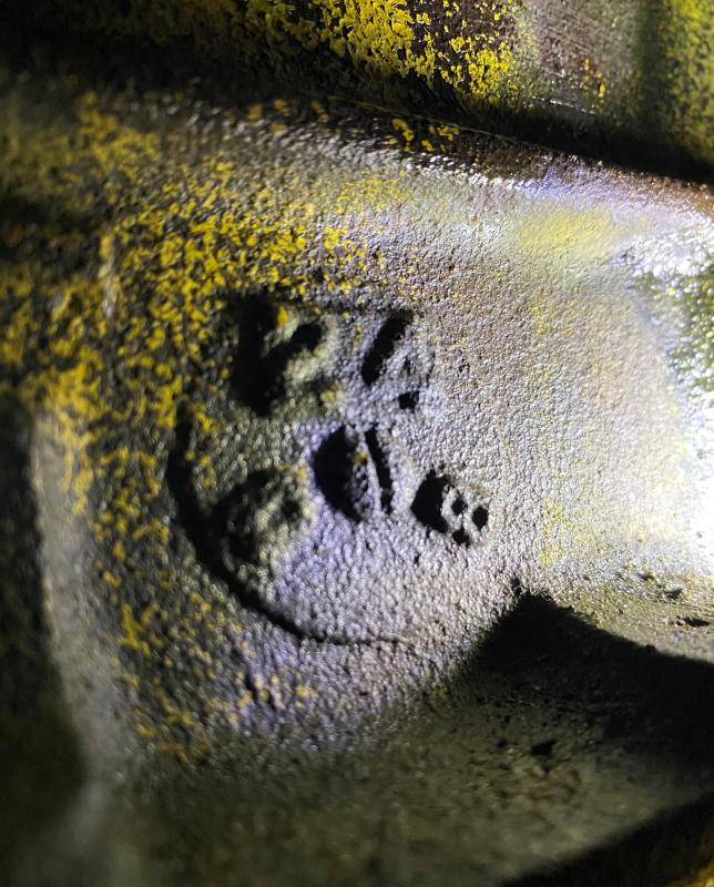

Good morning and Happy New Year to everyone. So I was able to clean the gunk and spray paint off the block so I could see the date code. Now how do I read it? I have attached the date code and the engine serial number.
Engine date Code 2a.jpgI am trying to buy a set of points and condenser for it, but when I talked to the local parts supplier, he said there was no listing for points on a 78 MGB. It stopped at 76 MGB, and 78 had electronic ignition. So obviously started me to think that this is not the original engine.
I may be mistaken, but the gold paint leads me to believe that's a Gold Seal engine; factory reconditioned. Looks like the "clock" designates 24th week of '78.

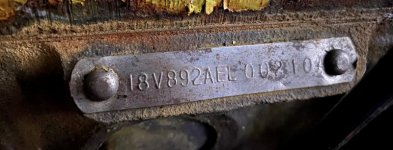

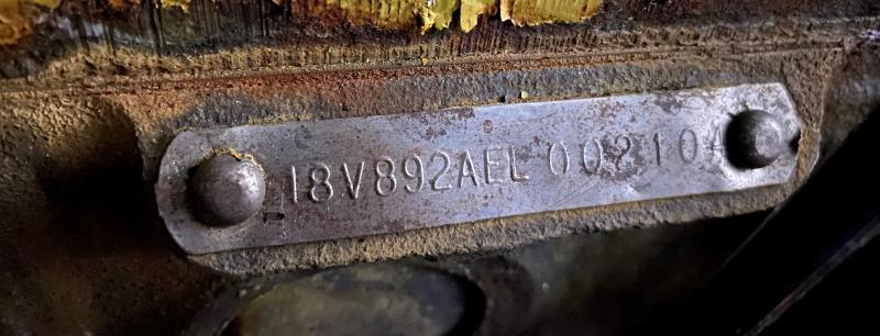

Did you locate the tag riveted to the block I mentioned earlier?
Points-type distributor may have been installed.
Thought I had sent it.
The number is 18V 892AE L 002104
