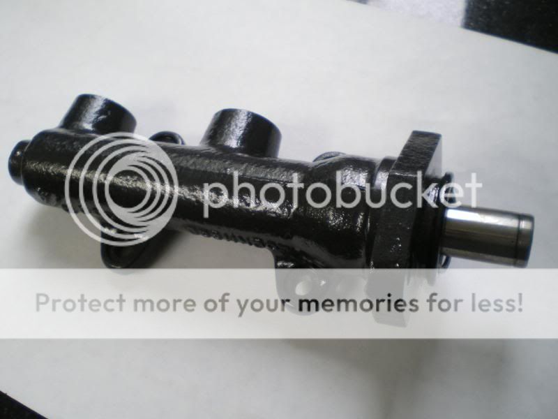

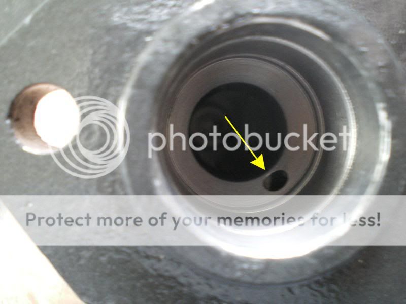

The one I have is pristine in every respect, but sleeving even a brand new one is probably the best option for longevity and trouble free service. All my cars are done with sleeved MC and have been for well over a dozen years. None have required rebuilding ever again. As I mentioned previously, the key to this particular one not leaking on you feet is a pristine surface on the front portion of the piston that passes externally. New seals will not help if there is any scoring/blemishes. The reason being is that there is a fluid port in the front of the MC (see pic), between the front bore piston and the external seal, so it's normal to have some fluid in that area. Just like any other lip seal, the surface it rides on is critical to it's functioning properly. I don't know if they make a Speedi-sleeve that size, but that is your only other option to correct it.
Original Lockheed MC
