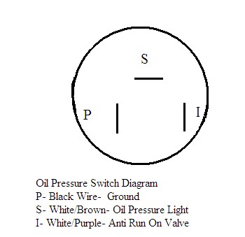

Connecting the 3 wires to the correct terminal on the switch is very important
"P" gets the Black
"S" gets the White/brown stripe
"I" gets the White/purple stripe
Here's a picture in case you can't see some very small letters on the switch. Not all switches have them.

But since the markings on the switch and/or the terminal position may not match Paul's diagram above, I might do some checking with an ohmmeter or powered test light. With the engine off and the wires disconnected, you should find continuity between the terminal for the black wire (ground) and the terminal for the white/brown. If not, either those are the wrong terminals or the switch is bad.
Hi. After double checking, I do have the "brake" light indicator on start up and I also have the oil pressure light when initially starting engine. The light is very faint compared to the ignition light but it is lighting.
The replacement switch had the same markings as the original P,S and I.
Thanks again.
