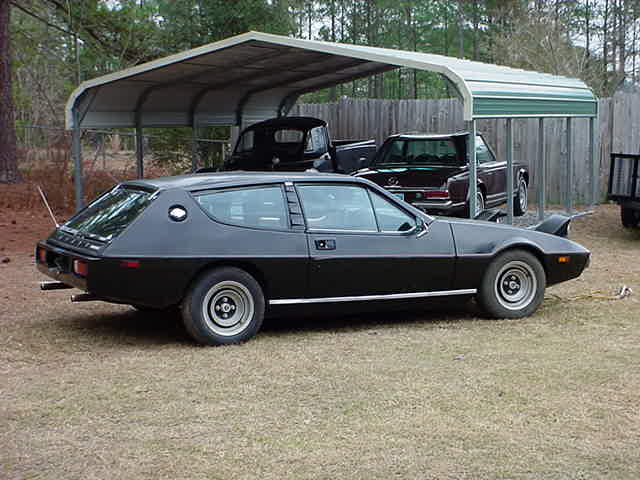

attached are a couple of pictures and also its cousin the jensen healey.

Read that and viewed the first photo....:"HEY! That's a Benz, not a Healey!" /ubbthreads/images/graemlins/grin.gif
And I see you've one of those stainless Volvos, too! /ubbthreads/images/graemlins/wink.gif
"WhatsThatNoise" has one'a them. Nice rollin' stock ya got. /ubbthreads/images/graemlins/thumbsup.gif
Nice mix of LBC's, Robert. Don't let Tony see that Morris pickup! /ubbthreads/images/graemlins/wink.gif

WhatsThatNoise said:
Sounds much better than a stainless Renault!
I deny the existence of any such animal as a "Stainless REE-Nough"! <plugs ears, hums to self: "Lalalalalaaaa, Means I love you...">
