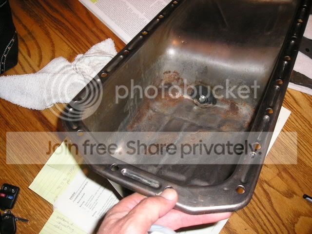

Oil pan is being cleaned for paint. Will be using new
split washers and new gasket(s), of course.
Cause we like pics, here is the inside of my oil pan.
Check out the rust. Any reason to be concerned, here?
Figure it's probably cool, what with the oil and all,
but just wanted to ask.

Looks like a pool of water accumulated there. Condensation, or head gasket leak?
You might want to treat the surface rust with a phosphoric acid type rust treatment.
I wouldn't put any type of coating over it afterwards because of danger of it coming off in the oil.

Yeah, what HE said. ^
Clean it up and be sure there's no "scale" then bolt it on.

<div class="ubbcode-block"><div class="ubbcode-header">Quote:]sand if off with scotch brite pad and your done[/QUOTE]
Agreed ---- NO paint needed in there.

2wrench,
All suggestions are great, just make sure the pan is absolutly clean from all scotch pad material as it will eat theough a set of bearings in short time. That kinda goes for any engine assembly, clean is critical.
