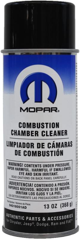

FWIW I was given this by my mechanic a couple years ago - transformed the car.
Seafoam might work also though I have never used it

Thanks for the info. Using a gas stabilizer and know I need to drive it more. I think the front carb is probably gummed up. Will check out the Mopar and Seafoam.
