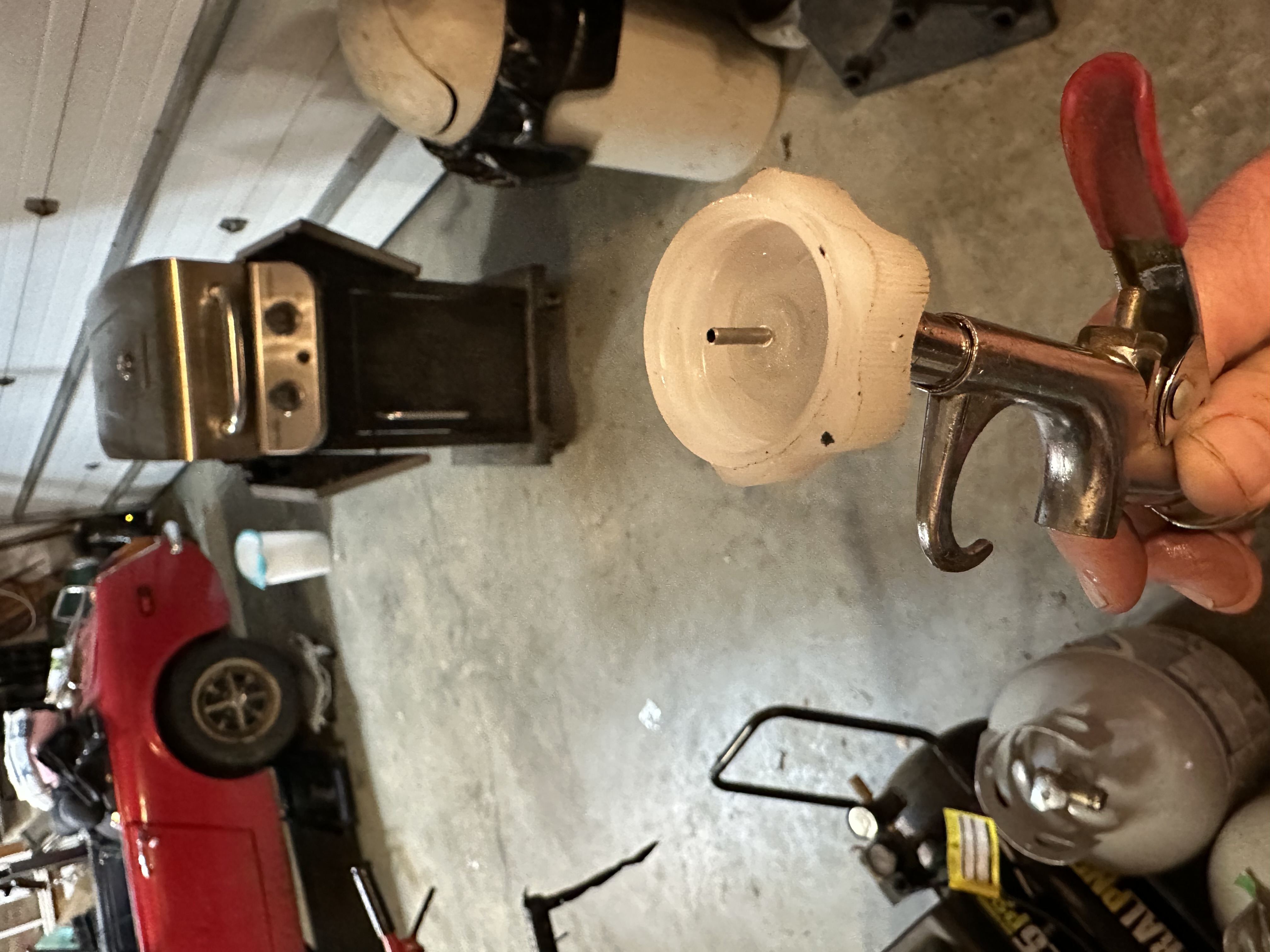

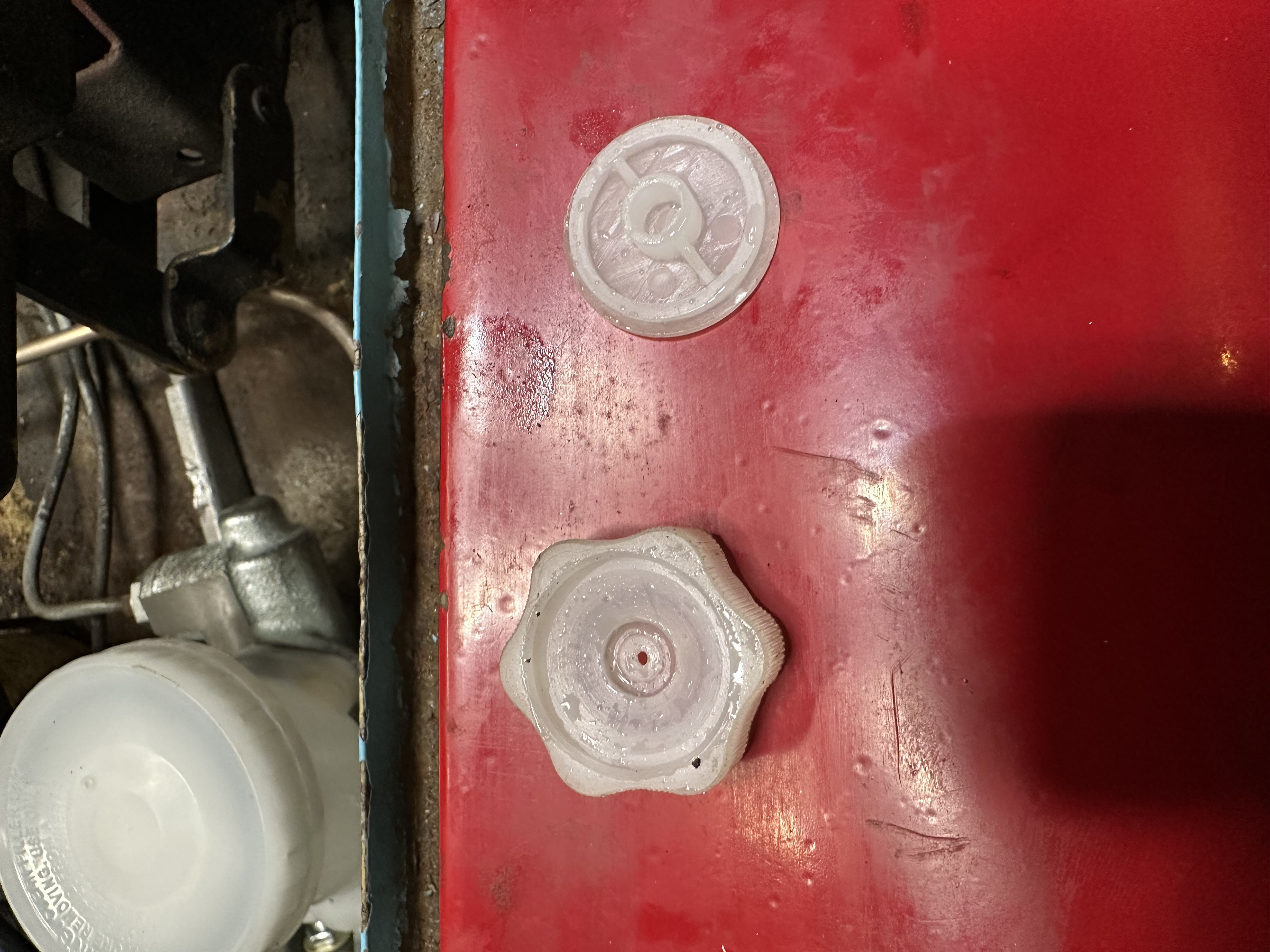

I got to thinking about the remote bleeder and how it seems to always be leaking so I took the top two pieces off and put Teflon tape on the threads just to make sure liquid wasn’t getting through. I then remembered that last night when I followed the instructions of the one video of clamping the socket into the slave and then pushing the clutch pedal that the lid on the master I bought from Moss Motors “blew it’s top”. I began to think this was a pressure relief and there was a small little hole in the cap. I took a ball pump needle and realized it was a little too big to fit, but that is a good thing. I pushed it through, turned on my compressor for ten seconds, put the cap on and pushed some air into the full reservoir which pushed the fluid through the line. Pushed about three 3/4 reservoirs through (with the bleeder open connected to the One Man Bleeder). After doing this, the clutch pedal seemed a little firmer, but still no where near where it needs to be. I’m happy to see there appears to be no leaks as the fluid holds it’s level with the clutch pedal pushed in and kept in as seen here (there are no air bubbles coming up either). I’m going to keep the clutch pushed in overnight /24 hrs just to make sure the levels stay put and to possibly get any trapped air out.

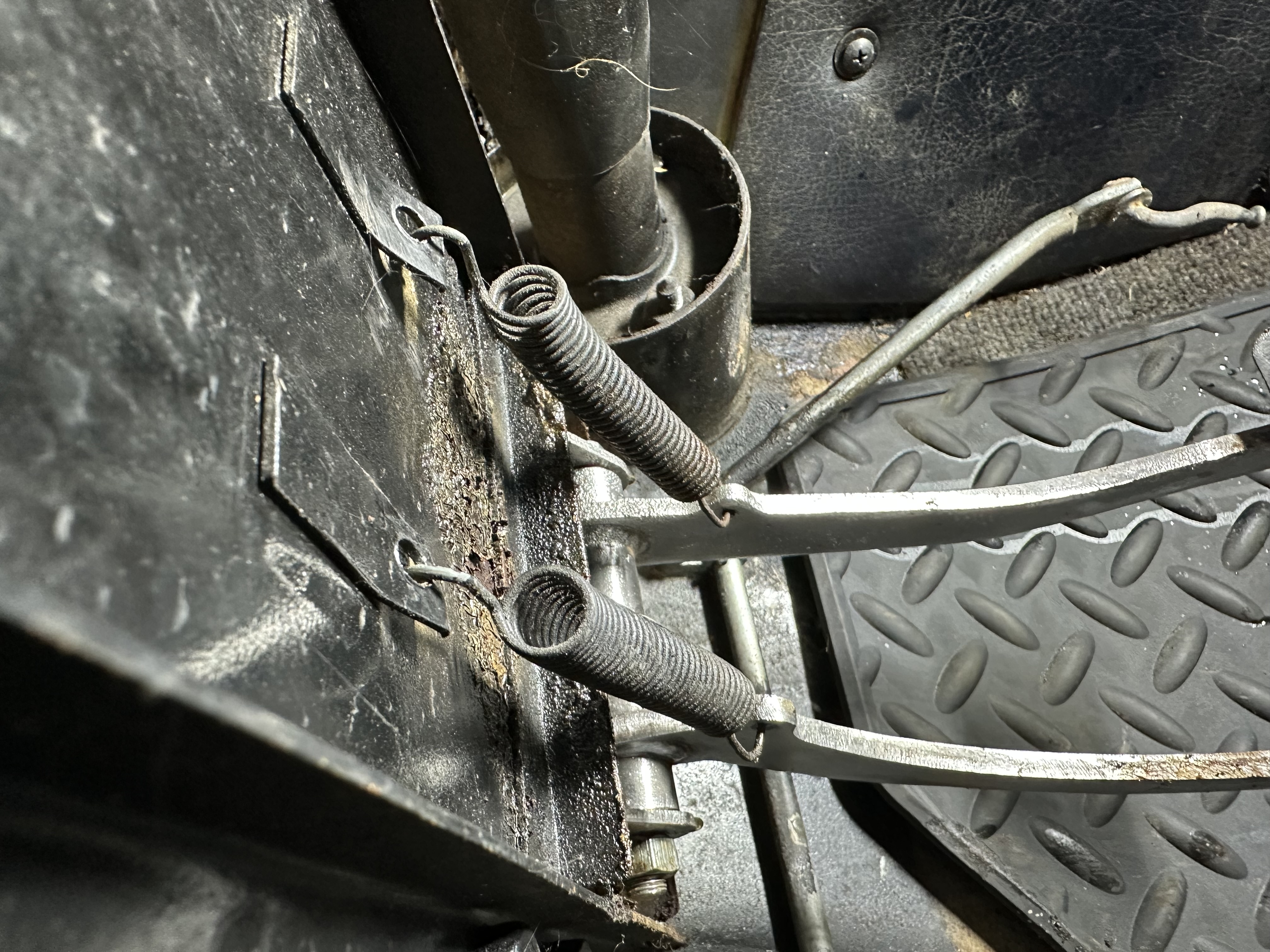

Trying to eliminate questions I have. The picture of the pedals shows where the springs are connected to the pedals and the car. Where the springs connect to the car, should the tab with the hole for the spring be closer to a 45°/90° or is it fine where it is?

When you clamped the slave in. How hard did you depress the peddle it should not have blown the top off the tank.

The springs look normal to me, just need to be at a slight angle so you can attach them. Not sure how firm the clutch pedal is supposed to be, mine is fairly easy to push down. How much slave cylinder travel of the rod do you have? Have you tried to put it in second gear when the engine is running to see if it's working at all?

Finally, a note on blowing the lid off the reservoir with the slave clamped. Under any normal circumstances, that will not help push any air out of the system. It will just compress it wherever it is. Once fully compressed, the pedal will just stop unless it is already down to the floor. I suppose it is conceivable that you could push on it hard enough to cause the rubber cups in the master cylinder to fail and let the fluid pass. If so, I would suspect permanent damage to the rubber.
