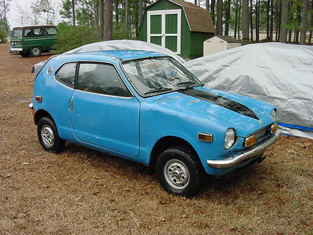

Well, I finally got the Honda home. I can't wait to start working on it.....it's remarkably clean and complete. I don't think it will take much to get it going. I know it definitely needs tires and brake work (as well as some proper wheels....mine are from a Z coupe), but engine-wise I'm hoping (and praying) that it fires right up. It's a little scary because it was driven up to the mid 90's, but has sat since 1995. Not knowing why it was parked is worrisome.....it might be because of a bad engine, who knows? I'll find out soon enough! :smile:

Now for the good news.......it runs! Sort of. The fuel pump isn't pumping.....I dumped some gas down the carb and it fires right up and runs until the gas is gone (~3 seconds). I sucked on the fuel line and got a mouthful of old gas, so I know there is no blockage in the lines. I think all I need is a new pump and it'll be good to go. I plan on draining the tank and cleaning it out while I'm at it....just makes sense.
I just might be able to get this thing roadworthy for less than $500! I'm stoked.....I was sure a rebuild was in my future.
Here's an update for those who might be interested. I pulled the fuel pump off and took it apart to find out it looks brand new inside. I bench tested it and it works just fine, so the issue was elsewhere. I pulled off the carb and discovered that the fuel inlet was plugged solid. I pulled the bowl off and cleaned everything up as best I could and re-installed everything. Now it fires up and runs fine....it just needs some tweaking to get it to idle correctly and of courdse it still needs tires and brakes and.....
I also bought another one! I found a '71 sedan on Craigslist and $400 later I owned it. It is also in great shape overall and will eventually be restored. My plan is to get the blue one roadworthy then start the restoration on the yellow one. Once it's done I'll tear the blue one apart and restore it. I hope to get both finished within 5 years....we'll see if that happens.
