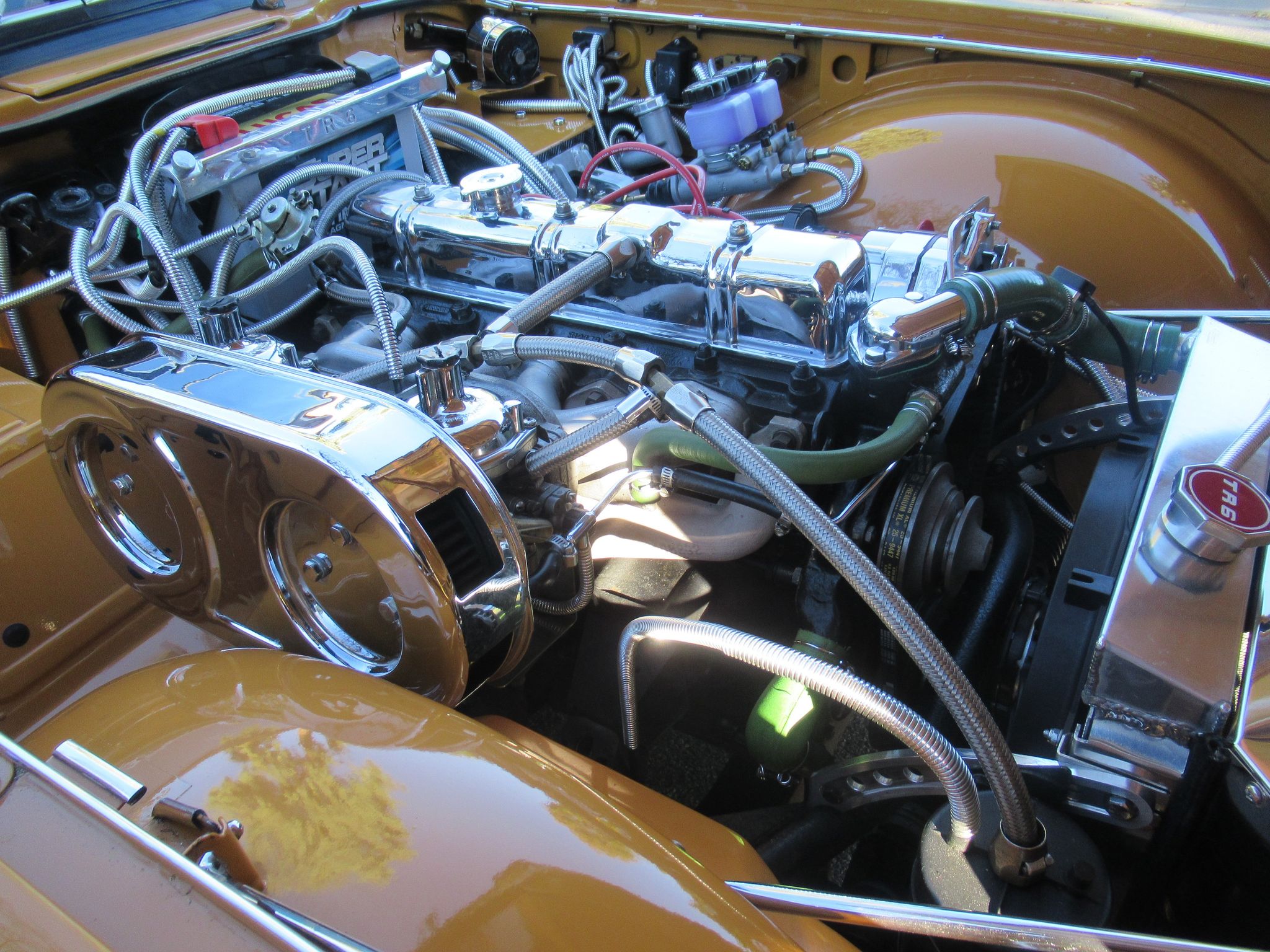

Hello,
Does anyone have shots of an original engine bay front fuel pipe setup from late 71 or early 72? There were three different setups over production, and the catalog is horrible about showing pictures. Mine had a crunched fuel pipe that passed under the water pump. Unlike the later cars that had a pipe that ran all the way from the fuel pump and around, mine did not.
Thanks.
Oh, on a related question. Did the line from the thermostsic switch to the distributor clip to the fuel pipe by the plug wires?
My '72 (build date 11/15/71) got from original owner in '79 fuel lines runs between bottom of thermostat housing & top of h20 pump
Hello,
Thanks.
Fuel line (encased in plastic loom) runs from fuel pump alongside engine block to connection between bottom of theromstat housing & top of water pump
