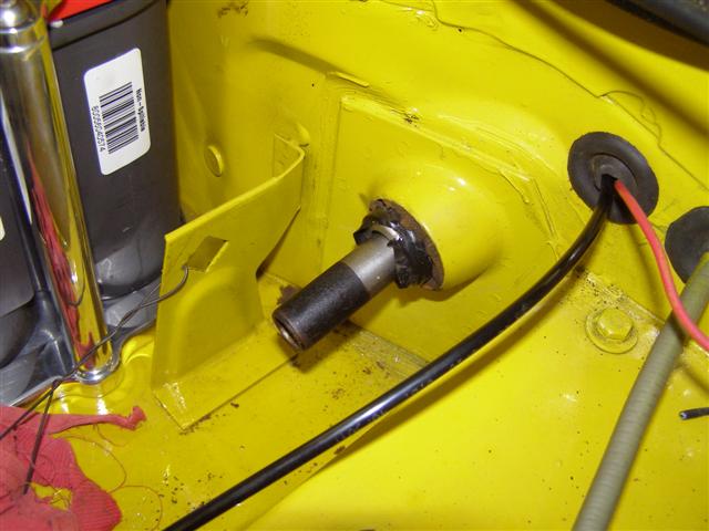

Since my car is on blocks while I work on other issues, I decided to referbish my steering column. I have put in new bushings in the cowling, installed new felt pads, and put in a new flexible coupling. I should mention that before this my steering column vibrated and the steering wheel itself rubbed against the steering column cowling (I'm not sure why.) I have never seen the steering column put together with the correct spacing; it was apart when I bought it, so I need some help. Does anyone know: 1) How far out into the engine bay does the steering column tube extend? 2) Is there a way to adjust how close the steering wheel is to the cowling, and if so, what should the distance be? Any tips or pics would greatly be appreciated.
Kevin
There is a stop that makes it self evident isn't there?
I thought I had a photo Kevin but can't find it.
This picture ought to answer that question.
