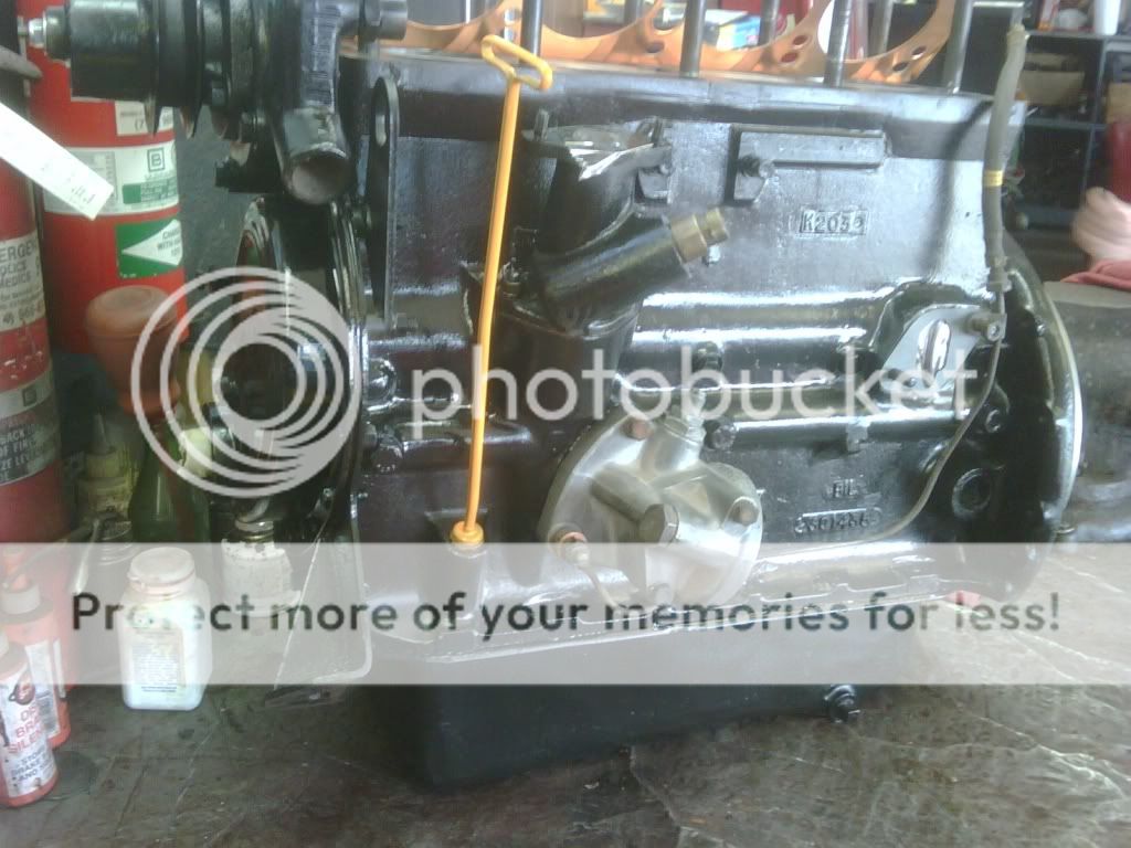

Engine rebuild nearly done... (not by me, wanted to make sure it was done right :laugh: )
Looking good Skip....Brosky would be proud of that dipstick.

I agree, that is looking good. Has that flywheel been lightened a bit? It looks like some material has been taken off the sides?
Just curious too, but is that flex pipe for the pressure gauge original on your 4A? My 4 came with a nylon pipe like a TR6 so I thought at some point in the TR4 production run they got rid of the flex pipe.
Gosh you guys have sharp eyes, even with a fuzzy phone camera picture!
Yes, I had about 4 pounds taken off the flywheel.
That flex line is definitely coming off, the core was bought with it but it is pretty scary looking. I've already gotten a dope slap over it from Chris (engine rebuilder). What would you recommend using there - steel braided one?
If good quality nylon ones still exist I'd say those work fine - direct from the hard line to the gauge.
