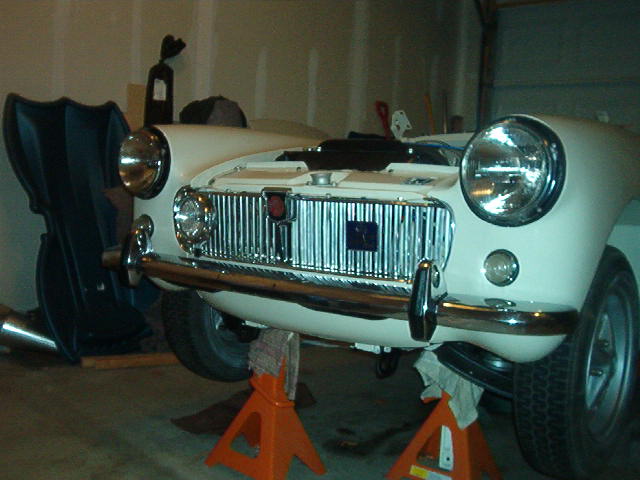

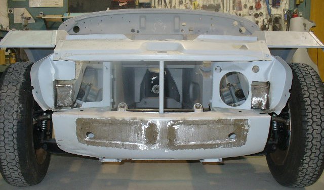

Here's what I did. Front, the rubber bumpers come off, the brackets get cut back and welded shut as they come through the grille opening. Then my body guy closed the two air vent holes below the grille opening and opened two holes for the new bumper brackets. The signal light openings are larger than on the 1275's and the signal lights will fit, but, I had mine closed and Bugeye beehive lights installed instead.

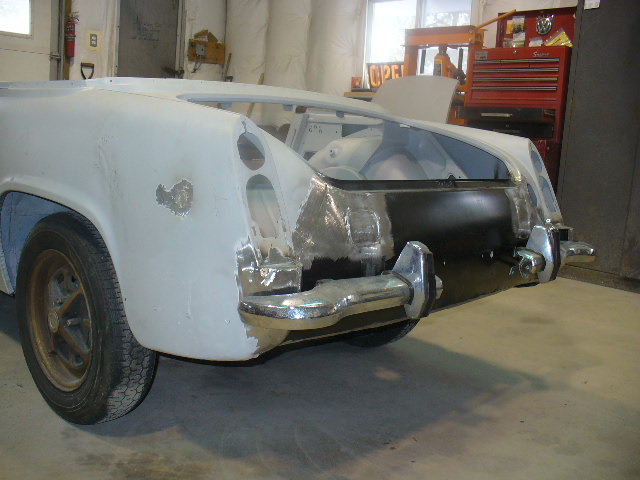

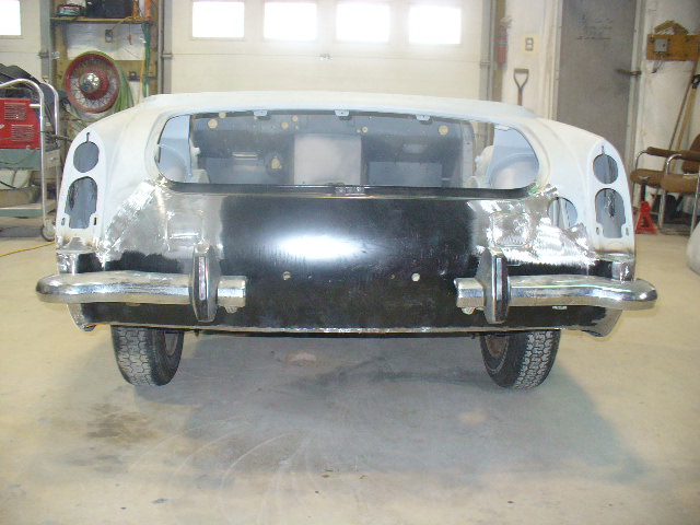

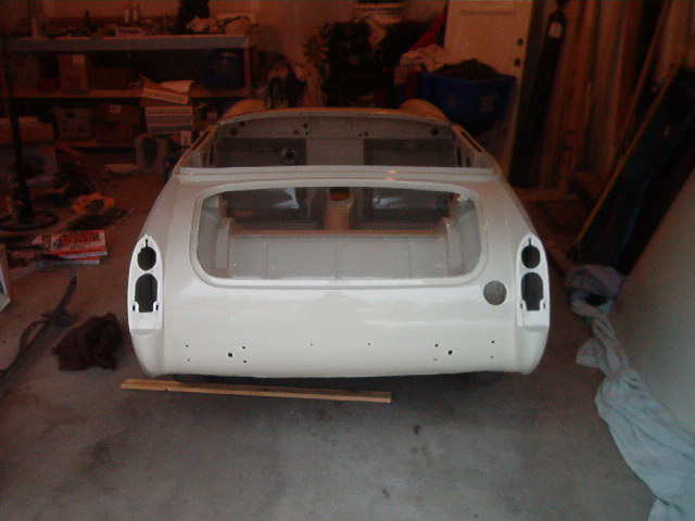

On the back, my car had been lightly rear ended and, as such we put a pre-rubber bumper valance in place instead. This matters because when you take off the rubber bumper, you will find that British Leyland cut off the bumps under the tailights to make the bumpers fit. There are various solutions ranging from people who just leave it to those who use foam bucks to those like me making it permanant. There is also the need to add an inner bracket.

Front
Rear (I also had the reverse lights removed)
Another View
Done
and rear
and inner bracket
