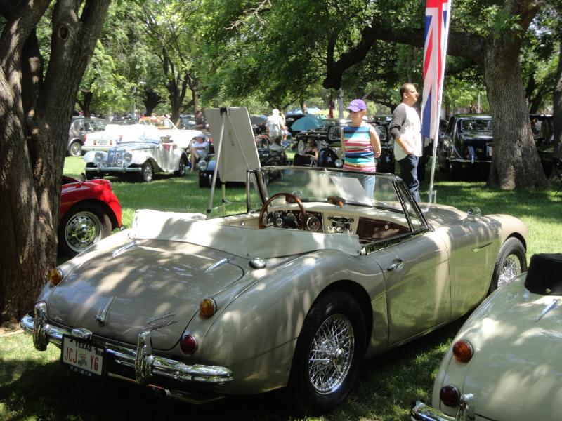

When I restored my BJ8 I purchased leaf-springs from Jule Enterprises that lowered my car to a level height. I also purchased new 60 spoke wire wheels and tires from Hendrix and the tires were about an inch taller and that gave me more ground clearance. I'm happy with the outcome.
Thanks Patrick that's a beautiful Healey & It's sitting much better than mine.
Bobbyd
Thanks Bobby. I can furnish tire details if you want? The leaf springs from Jule were about $300. Shipping was not an issue since they came back with my car.

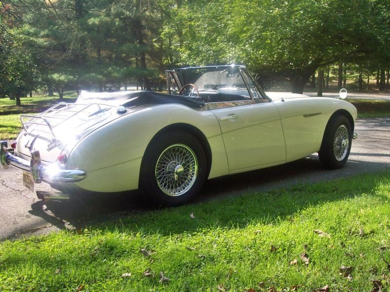

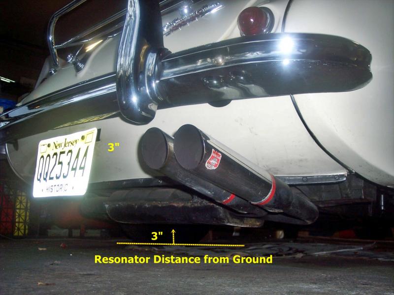

I appreciate the efforts you had to extend to lower your BJ8P2 to sit where I had great difficulty raising my BJ8P1 to. If the springs were mounted blow the frame, the use of blocks and the like would make this task relatively easy. However, having the springs and rear axel mounted above the frame makes the task a less then straight forward.
attachment.php
attachment.php
My reason for raising the height of my Healey was not just for looks. Since the P1 and P2 share the same exhaust system, including resonator across the bottom of the boot, clearance and lost exhaust components were things I tried to diminish with the added height.
Bobby, I appreciate your desire to reduce the height of your P2 as did but I also would query Martin on the other spring mods he has suggested in the past.
