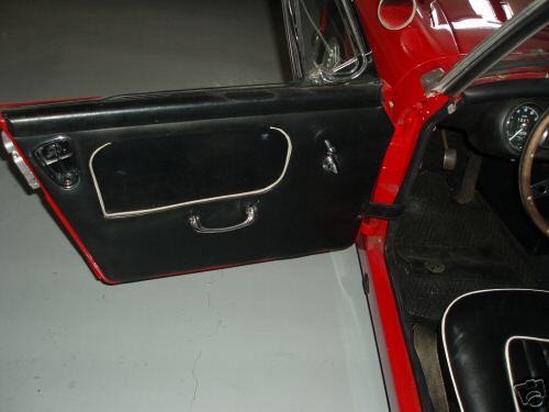

Just looking at pics in Horler The orginal Sprite & Midget. The door covering is set back from the edge so that the rubber contacts the metal part of the door and the trim part overlaps the door panel a bit.
Picture I scooped from ebay 1965 MG Midget
Mark
See that small lip of red around the edge, the rubber goes there. The trim strip goes against the door panel.
