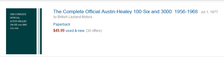

I see this is currently out of print, but they're available used on Amazon and abebooks.com.
See:View attachment 35898
