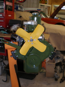

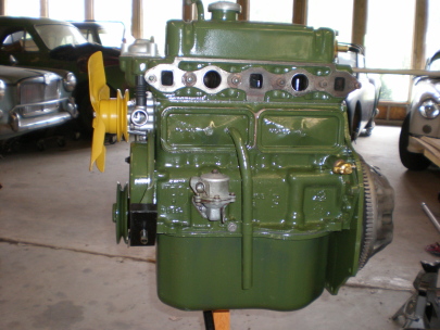

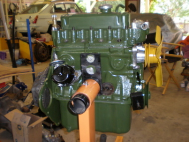

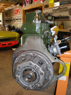

As of today...dummy me, when I ordered all new head stuff, I forgot to order new head stud washers! So, won't torque head until the new washers arrive...still got a few things to do though (haven't riveted plates on valve cover, for example).
Anyway, if I ever build another Midget engine, I've got the engine stand

Looking like a good little engine should.
That's looking really sharp Tony! I keep forgetting early cars have a draft tube off the tappet cover. What's the PSI of the mechanical fuel pumps? Are you going with the original timing marks, or have you setup something similar to what Hap does on his motors?
