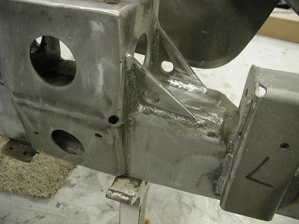

Interesting, when I inspected my chassis after media blasting I found the motor mounts on the frame to be stress cracked....every one! This really surprised me because my car was a pretty low mileage car....35,000 on the clock and the speedo was working...and this car was not raced. I didn't find any issues with the motor mount brackets that Dougie is showing. I've added 4 gussets to each motor mount pedistal. Pic enclosed show 2 of the 4 on drivers side. Oh, and I cut the mounts opened and welded up the cracks on the inside of the motor mounts before closing up and putting in the gussets.
You guys might want to check yours.
