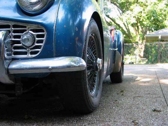

It looks like a 6" would easily work, if the offset is such that the extra 1" is to the inside. A 6" with the same offset as my wheels would be very, very close to rubbing the fender.
Moss sells a 5.5" Mini-lite replica they say fits TR2-TR4, so 5.5" should work.
Sorry I can't give a more definitive answer.
-Jiri
(see attachment for idea of clearance)
