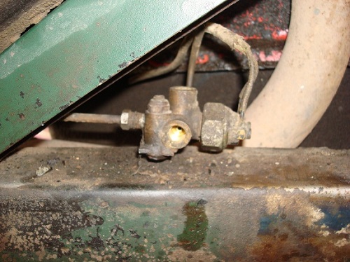

Does it look like this? Most frames were painted black, but if they had body color paint left over when they started a frame run they would use up that paint on the frames. This frame is on my 56 Blue TR3

Yep, That is what it looks like. Is your car still unrestored? And if you were to restore it,would you opt for the green frame?

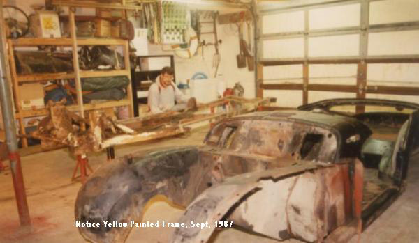

I bought my 1958 TR3A brand new from a TR dealer here but paid $35.00 for the option of having it tar coated all over the underside my black TR. In 1987 when I was starting to restore it, I found that the frame was painted primrose yellow where the tar was still providing some protection.
I wrote Bill Piggott and he told me that in England the bottom is called "the black works" and he had never seen or heard of any TR with any other colour.
BTW, primrose yellow was not yet a TR3A colour in February 1958 when mine was built. But is became available a few months later.
