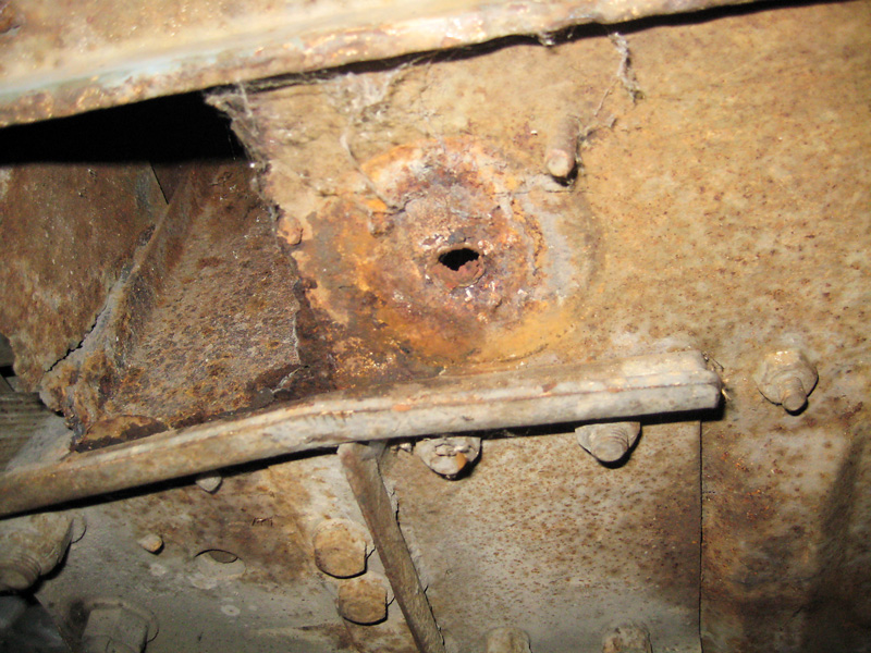

Hows this? This is a shot of the passengers side inner quarter panel support and inner wheel arch. This area was completely gone on both sides. Actually when I started tearing it all apart my floor pans didn't look as bad as yours in that area. The damage inside that area is usually worse than on the outside. I don't think the factory put any effort at all into corrosion prevention. Probably wasn't a high emphasis item on those days. I'll update that album soon when I knock out some more work. I just ordered the stuff necessary to attempt lead soldering of the body panels...that ought to be entertaining!

this is just the typical snowball effect i guess..i'm thinking about cutiing out the bulkhead support first 'cause i'm probably going to have to replace that anyway..maybe i can get better look iside the spring box from there?
under that bulkhead stiffener is the inner bulkhead. If that sheet metal is intact(and it probably isn't)you won't be able to see into the spring box area. I started out going that direction, hoping to save the spring perches and just splice in new sheetmetal on the bulkheads and floor as needed. But the more I opened up, the more damage I saw. I honestly don't know how the rear springs remained attached to the car as long as they did! I ended up changing both inner and outer rockers, one complete floor pan, both floor stiffeners, both bulkhead stiffeners, both bulkheads and spring perches, both inner and outer wheel arches and quarter panel patch panels on both quarters in front of and behind the wheel wells. Hopefully yours is no where near that bad. I'd actually like to do all this again but using a different approach; I'd like to split the car in half at the rear bulkhead and build up the spring box assembly outside the car then install it on the back half first, then reattach the two halves of the car. I'd also like to make my own bulkheads. The ones available are made out of thinner metal and were very hard for me to work with. After writing this I think I must be insane!
darn mark..if i started all that i'd be divorced and sleeping in the car, which half would be more comfy do you think?..when i cut the stiffener out i had to cut a small section to see the spring..the inner bulkhead was rotted in a small piece at the bottom that i cut out and can replace easy enough.the sides and bottom of the spring box are intact, just full of a lot of crap that i scraped out.. i guess i got lucky but also this is one side of 2, who knows what's waiting for me on the other side.. if you'd like to do it again i'd like to be the first to offer to drop this off to you and you can have a ball with it..anyone owning a british car has to have some degree of insanity i assume..thanks everyone for your help and i'll let you know how it's going as i move slowly along
