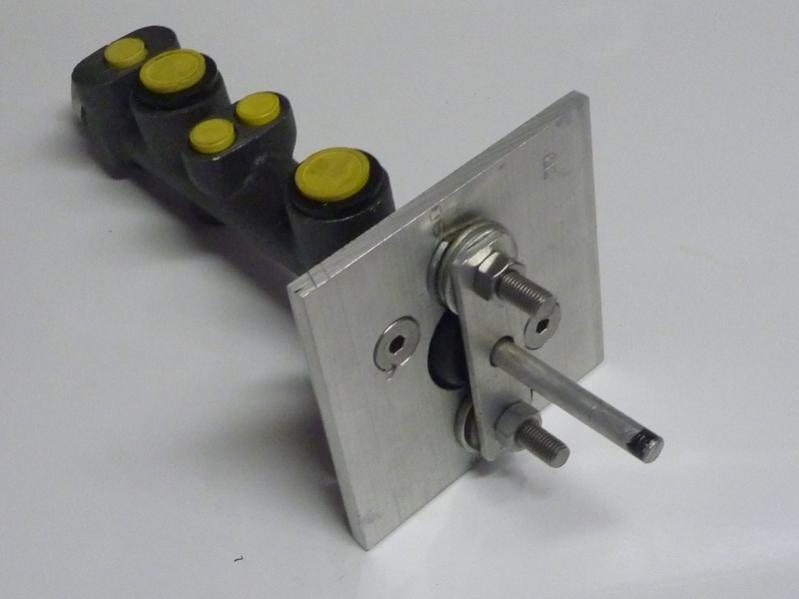

I'm using a Nissan B210, dual-circuit master cylinder for the brakes and the standard mc for the clutch. My BN4 is a '57 with 4-wheel discs.
Later this year, I'll be installing a Fiat 124/131 tandem 3/4" master cylinder - available on Amazon for around $40.
Mount flange is angled, so I made an adapter plate as shown.
Pictures of project so far:
https://www.pbase.com/stevegerow/dualmcproject
Clutch is standard.
