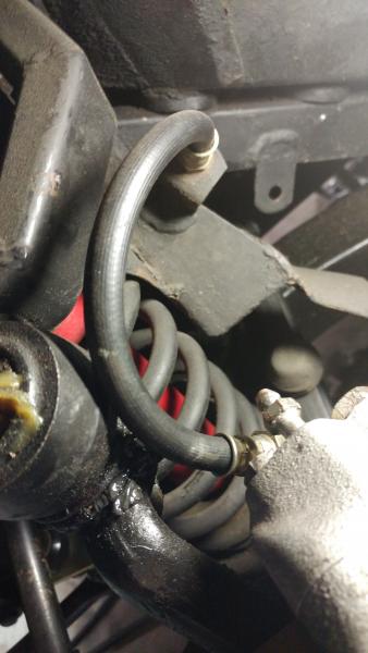

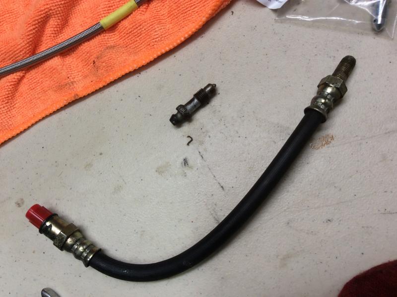

The old rubber hoses appeared in good shape.

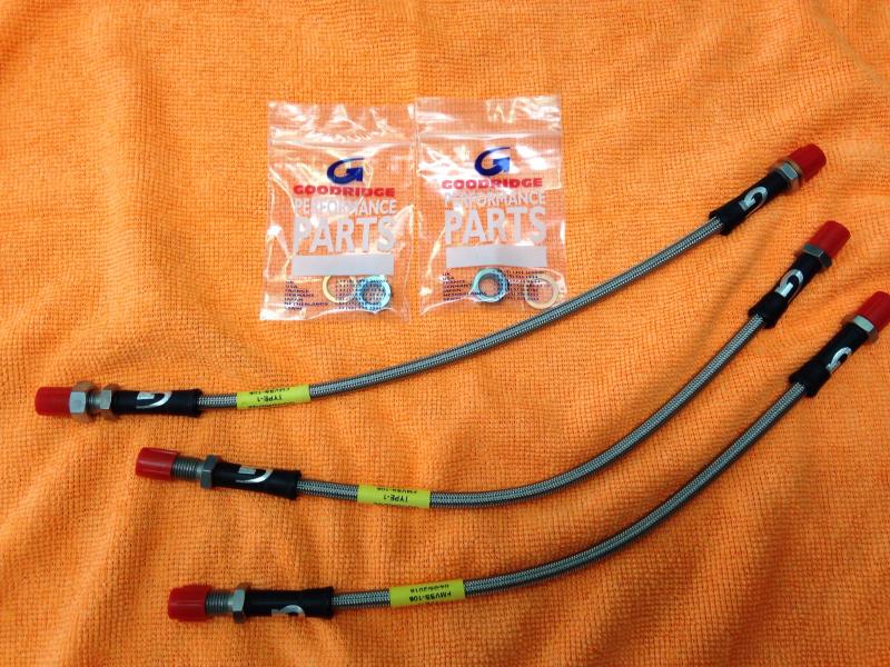

But I got a good price on the 3 stainless steel hoses from TRF, and the upgrade is suppose to enhance brake performance.

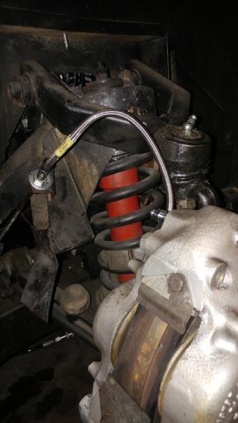

the Goodridge braided stainless steel hoses are top shelf. Very well made. They fit perfectly.
after installation I bleed the lines, but I will bleed them again before I put he wheels back on.
Braking is as good or better.
