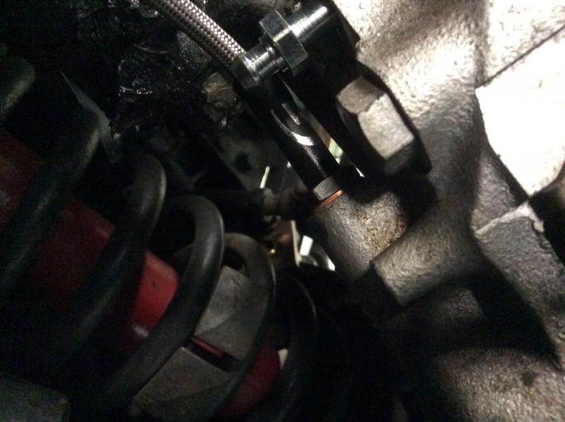

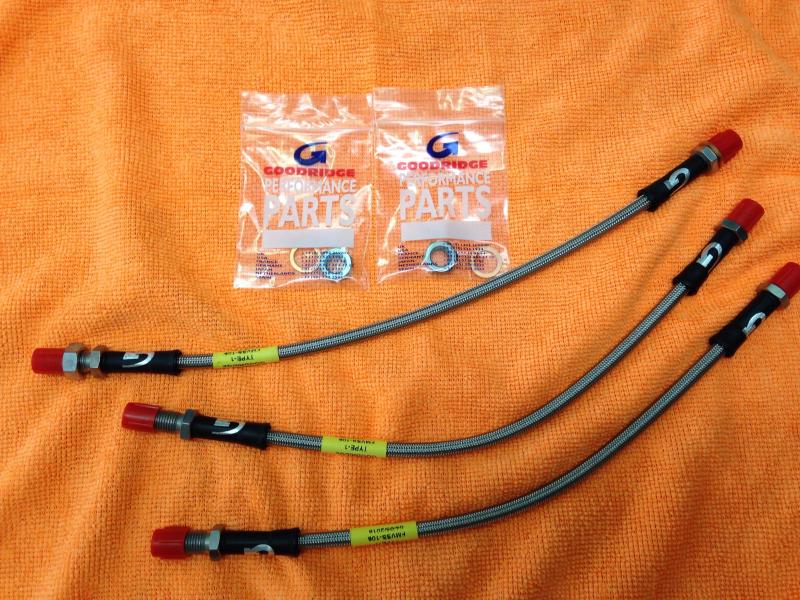

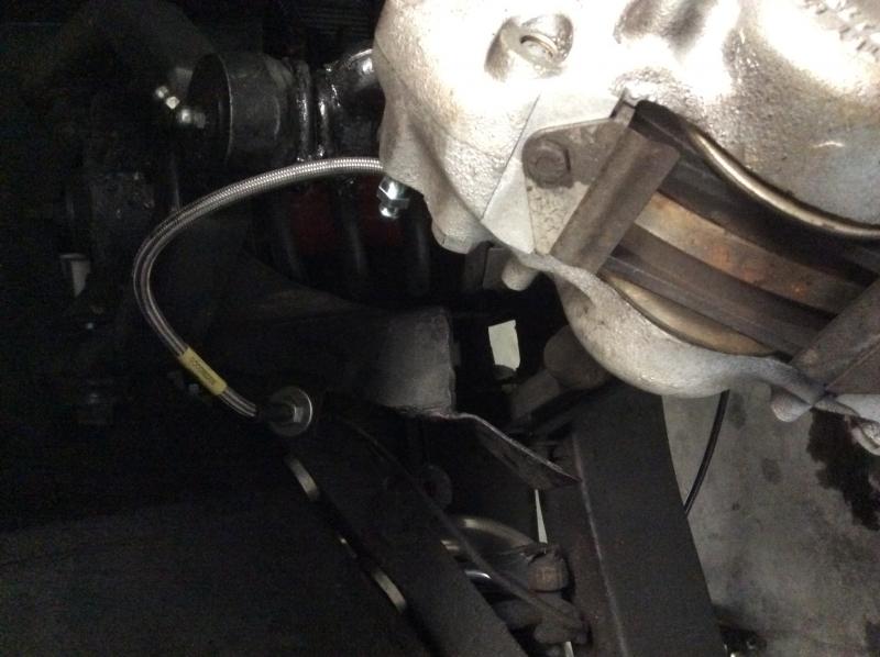

7/16/2016:
Finally got he ss braided brake hoses:
worth the wait.
Made by goodridge.
