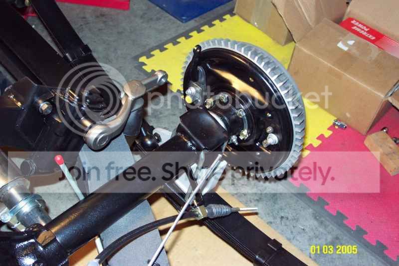

A fairly obvious difference between the 4A solid axle and the 4 : The 4A unit has a flat pad on the top as well as the spring pad on the bottom. The TR4 unit doesn't (the area on top is just the round tube).
