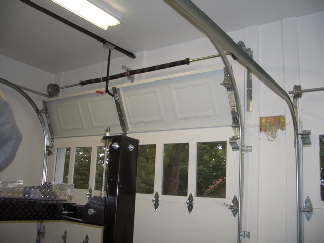

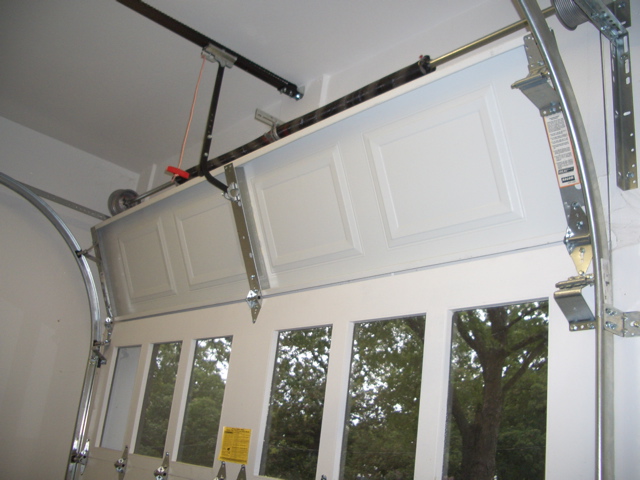

Assuming you have the headroom (I have 12 ft ceilings) you just need to get a high-lift track and a dummy panel at the top of your door so that it will lift the door high enough. From the outside it will appear no different than before. I love my four post lift - it turned my 2 car garage into a 3 car and it is great for working on the Healey.

Ray, attached is a picture of the high lift tracks.

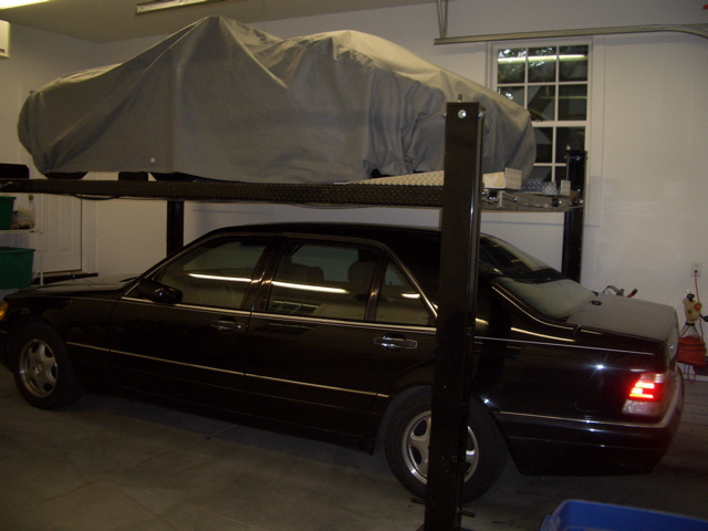

[ QUOTE ]
Here's the lift with my other car parked under.
[/ QUOTE ]
OK Wana now color me BRG with serious envy /ubbthreads/images/graemlins/crazyeyes.gif /ubbthreads/images/graemlins/crazyeyes.gif

Thanks for sending the pics. This really gives me a good idea of how it should be installed. Have received a quote for $1400. for a new door and high lift kit. Does that sound about right?
Wana, is this in the ball park of your cost?
Ray, I guess it depends on the door, etc. I think my door plus high-lift track came to around $1050 plus installation. I have found very few jobs that I couldn't do having the Healey on my four post lift. I have changed the exhaust, put on 4 new shocks, hubs, wheels, changed the oil, done all the lubrication, etc. The key is getting jack bridges so that you can raise the car up off the runways and place jackstands on the bridges so that wheels can be removed, etc. while on the lift.
