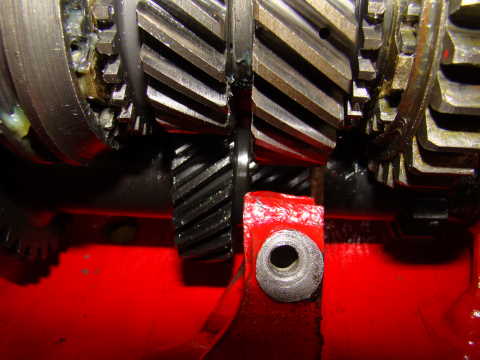

Finished assembling the main gearset in my BJ7 and after installing the selector forks and shafts discoverd I can no longer shift into 3rd or 4th gear? I have the transmission out of the car and sitting on my workbench and am in the process of making sure I can shift manually all gears. I replaced the lay gear, reverse gear, and 1st gear with hub. All those work super smooth now but when trying 3rd or 4th, no luck. removed the (3rd/4th) shaft thinking it could be binding, nope, it's something inside the sliding hub. Oh, I also replaced all 3 baulk rings/synchros. I'm thinking the new synchros are preventing the hub from sliding. Any other ideas I'm overlooking? Has anyone else had this problem? Reluctantly, I now have to remove the gear set and replace the new baulk rings with the originals and try that. I thought I'd ask here first though. Any ideas? :confuse:
Oh, I installed the 3rd/4th rings facing each other (you know the points facing the center of the hub, I think thats correct.

If you can't slide the outer collar of the 3rd/4th synchromesh hub, the balls/springs could be holding it up.
I think it would be impossible to install the synchro rings incorrectly, but if the outer diameter of the "points" is too great, that would prevent the collar from sliding over them.
Compare the new rings to the old ones by putting them against each other.
BTW, did you take the synchro-hub apart; because if it doesn't have the correct orientation between the inner/outer halves, it won't work.
See:
As always Randy, thanks so much for looking at my problem. I didn't remove the sliding hub, but not that the PO may have. How do I know which is correct? I can't tell from the excellent photo's shown? Do you merely align the inner half section with the gaps? I remember replacing the springs and balls but as for as I can tell it looked okay. Are you saying I wouldn't of been able to slide the hub far enough to engage the gear if it were installed wrong?
I did compare the brass synchros with the originals and they looked very much the same except (In diameter, meaning the tops all aligned correctly)only not as worn.
With the gear set in the transmission I cannot slide the outer hub either direction far enough to engage the gears. What's wrong? Is it turned in the wrong direction? Do I need to flip it around?
It should go on the mainshaft as shown in the last picture posted above, but I don't think you could've put it together wrong, I don't think there's "room" to put it togther backwards.
Yes, the gaps inner/outer, should be aligned. After thinking about it, I don't think the rings could go in if they're not aligned.
I think you're going to have to pull it apart and see why the hub doesn't slide.

:yesnod: I found the problem and the problem was ME! If you look at your photos (6th from the top) you'll notice the inner hub has a NOSE pointing up. That part goes into the driven gear in the front. I had it reversed. I'm only glad that in fact it wasn't able to shift into 3rd or 4th, even with difficulty, I may have forgotten about it until I had the transmission in the car. So, all I did was with the case in a vise (Nose part down) was lift out the rear main gear cluster, flip over the 3rd/4th hubs with the longer nose part down into the driven gear and voila! All works just fine now. With plenty of grease in the shaft even the roller pins stayed put when I lifted it out. BTW I discovered when first installing the main gear cluster into the driven gear in front, if you place the rollers with lots of grease, and secured with two rubber bands, around the main shaft you can easily lower the gear set down into the driven gear by yourself pretty easily.
