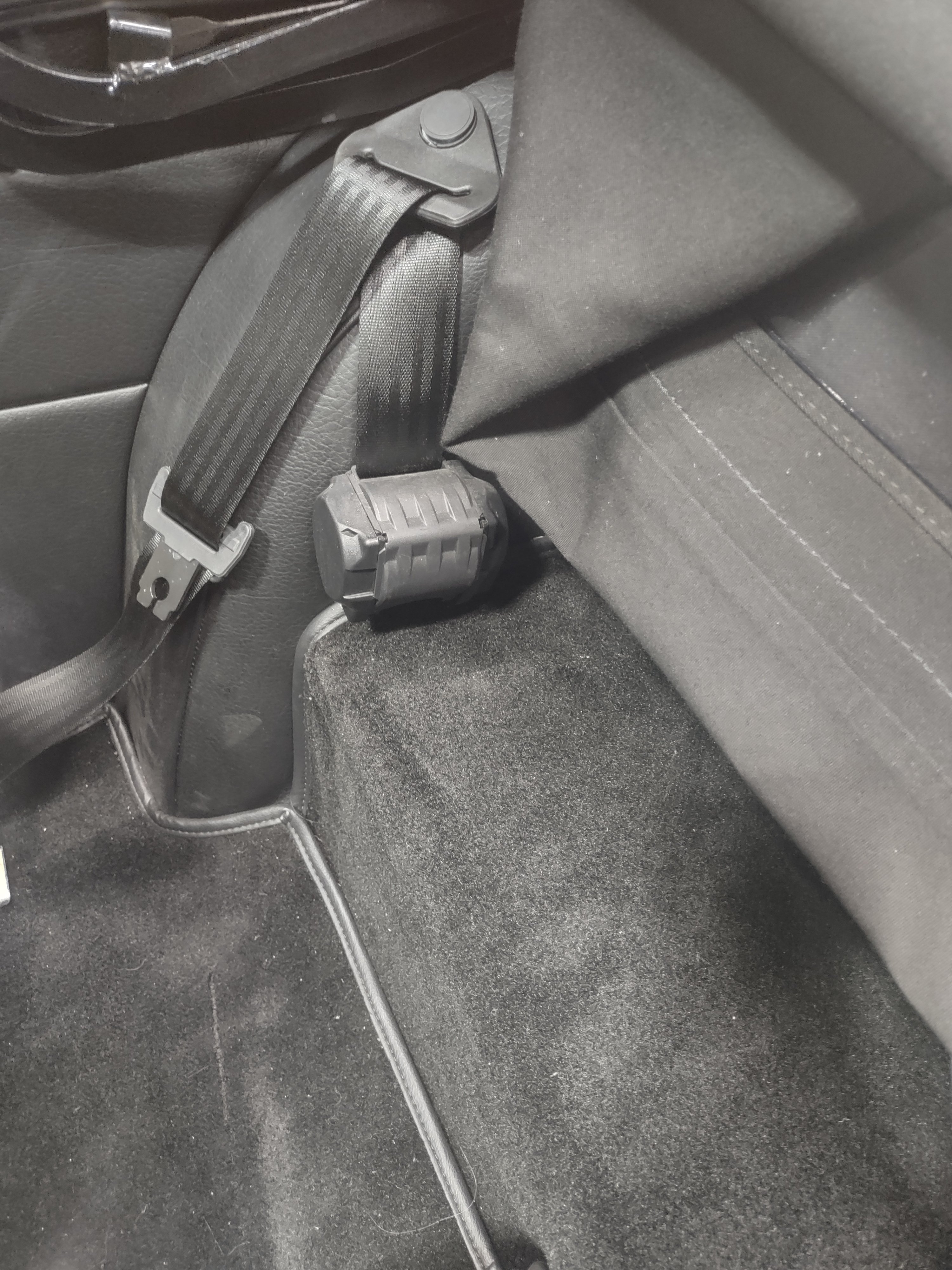

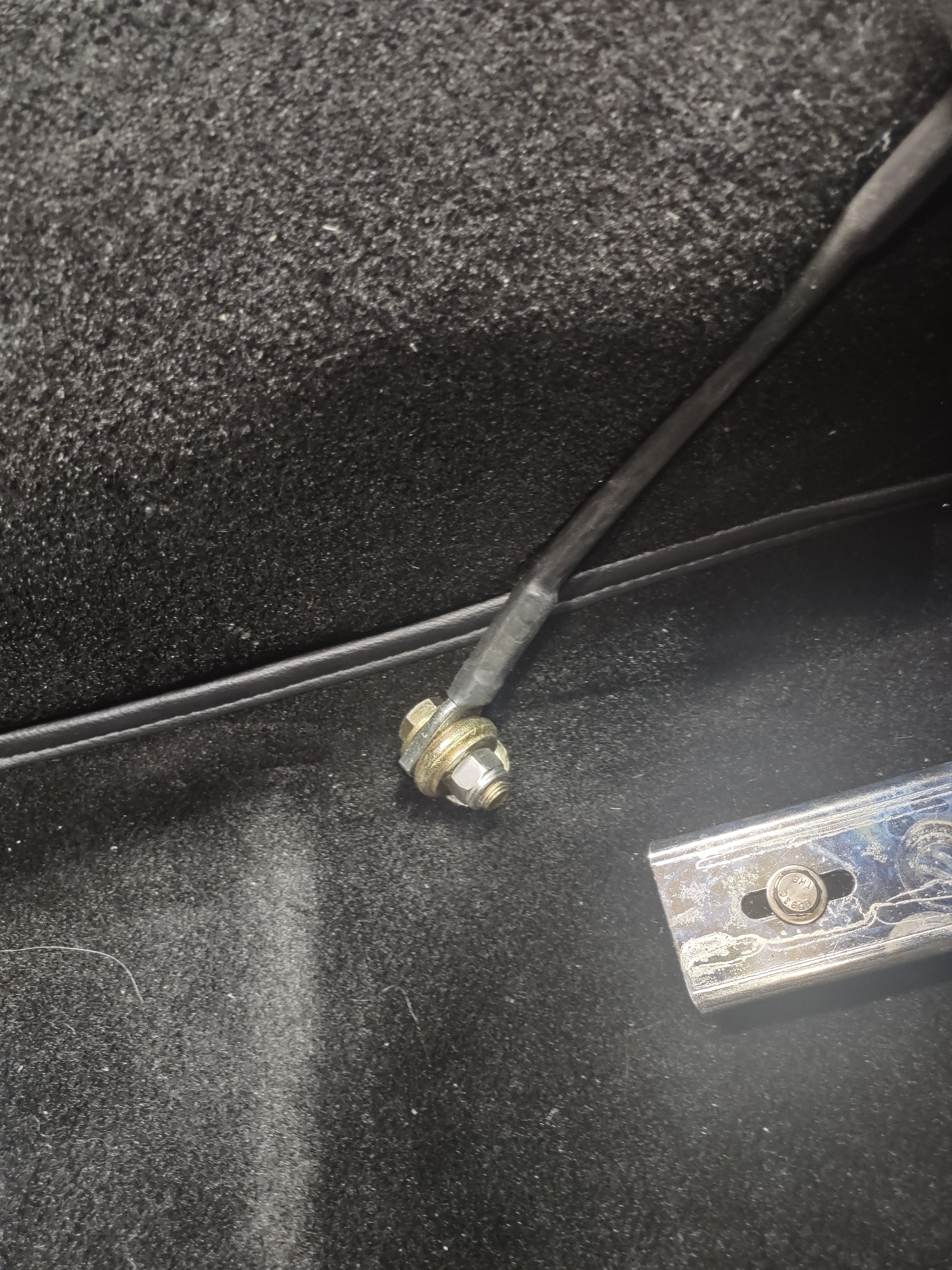

This is how my 73/74 TR6 attaches. The buckle side comes out horizontal if you bolt it directly to the floor board if you purchased the same one I did. I installed an eyelet from a race set of belts and cross bolted it to get the buckle vertical. Not enough room for it to be horizontal.
