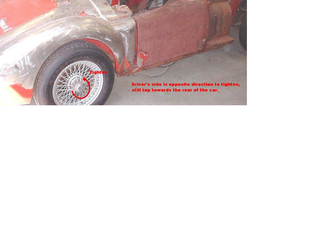

The hubs are "handed" that is they are either for the right or left side and the threads are either right or left twist to match. If you have three knock offs that are "right handed" then you have an incorrect hub on one postion of the car and that is dangerous. You'll never be able to keep a knock off tight on that hub. The knock offs are designed so that if you look at the knock off to tighten it you would move the top edge or ear towards the rear of the car. Check your hubs again and replace the one that is incorrect for that side. The most common error is done when doing maintenance and the hubs for the left and right side are interchanged inadvertently.

Thanks Bill. Above all I want to make sure i'm safe. The HUB I need is for the drivers side rear. I checked the other side and the thread is correct for that side turning toward the back as your picture describes. It must have been swapped out at some time with the wrong hub so now I have two right hand rear hubs on my car.
