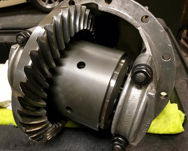

Here's the secret to an ulta quiet set of long lasting gears. I've had this process done on the new 4.3 gears for my vintage racer and the 3.5 gears for my street Healey. No addition noise, just the sweet sound of the big six.
https://weddleindustries.com/services/house-rem-polishing-process-weddle-industries
Dougie, I believe you have something there. The extra processes such as what you have shown I believe certainly go along way towards solving the problem. Unfortunately I believe that the parts for things such as the Healey ring & pinion which we have been buying from the aftermarket fall way short of the finishing processes described here. Had I known this process, and I'm sure I would have if I'd of looked for it, would I have popped for the expenditure of the additional procedure or would I have done what is routinely done and taken it out of the box, given it a cursory cleaning and inspection and then installed them. Obviously & unfortunately what I did and my installer as well was the later.
