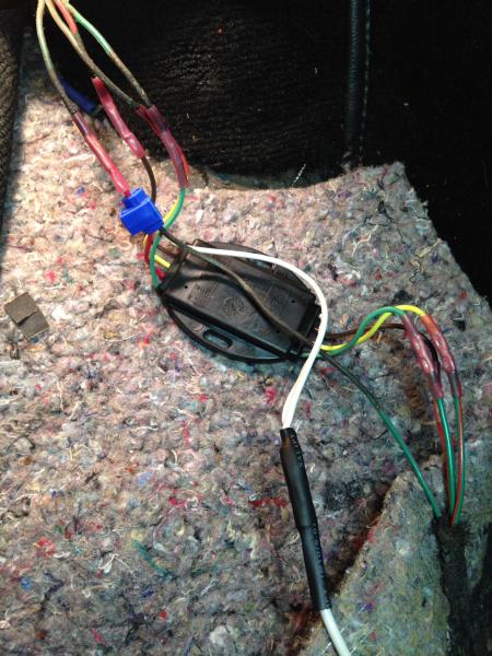

i installed a hoppy trailer adapter to add the rear turn signals into the brake light circuit.
this was fairly easy to do & the instructions provided in the forum were spot on.

Update: I used a line splice connector ,( note blue box connector in pic). As a simple way to splice a line into the harness. I may have put to much pressure on it. As I haven't used one before, but it failed in Just a few hours: take home is keep the butt crimps & soldering iron handy.
