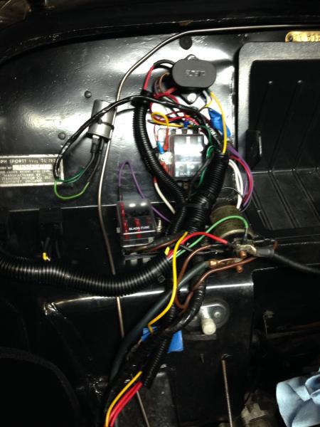

Gradually and a lot more slowly than I thought, I am getting my wiring under control.
having removed the original two fuse bus and replaced with two 6 fuse boxes with main power terminals, it became a matter of choosing what to switch fuse, what to unswitched fuse & what to just run to a terminal.
A brief description:
switched modules:
Electric fuel pump
starter relay
tail lights
brake lights
wipers
OD switch
unswitched modules:
horns
override fan switch
Fuel pump safety switch & relay
lighter outlets ( on the list)
i am waiting on a headlight harness from advance auto wire.
once I get that installed, I think my wiring days will be over.
However, I can say I have gotten pretty good at crimping/soldering & heat shrinking.
switched modules:
Electric fuel pump
starter relay
tail lights
brake lights
wipers
OD switch
unswitched modules:
horns
override fan switch
