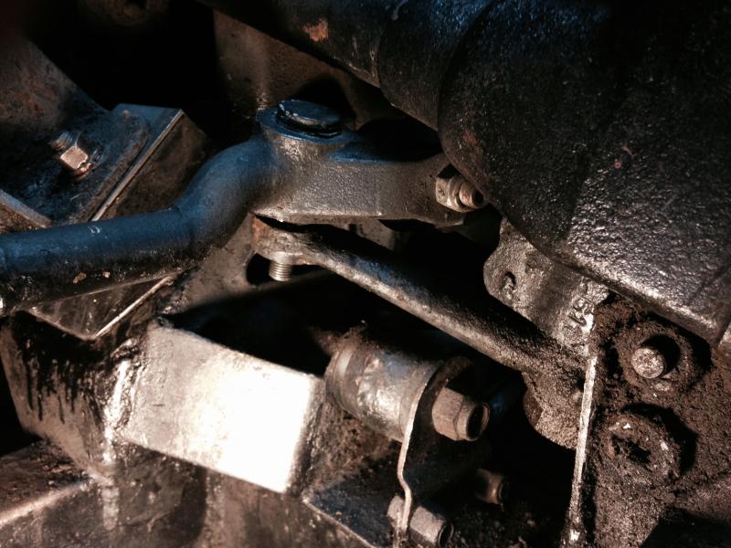

I got started on the stator tube & wiring.
No problem removing the horn head plate from the steering wheel or the stator tube.
but the drop arm linkage stalled me out.
without the proper pitman gear puller it is next to impossible to separate the two linkages, w/o damage to something. I'll check around tomorrow for a rental.
i'm sure I'll need to separate this anyway, even if I do decide on R&P.
