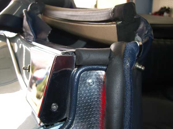

1) does the finisher beading on the trim panel on the door latch side goo up the side and over the top of the panel, stopping at the inner door seal or just up the side of the panel).

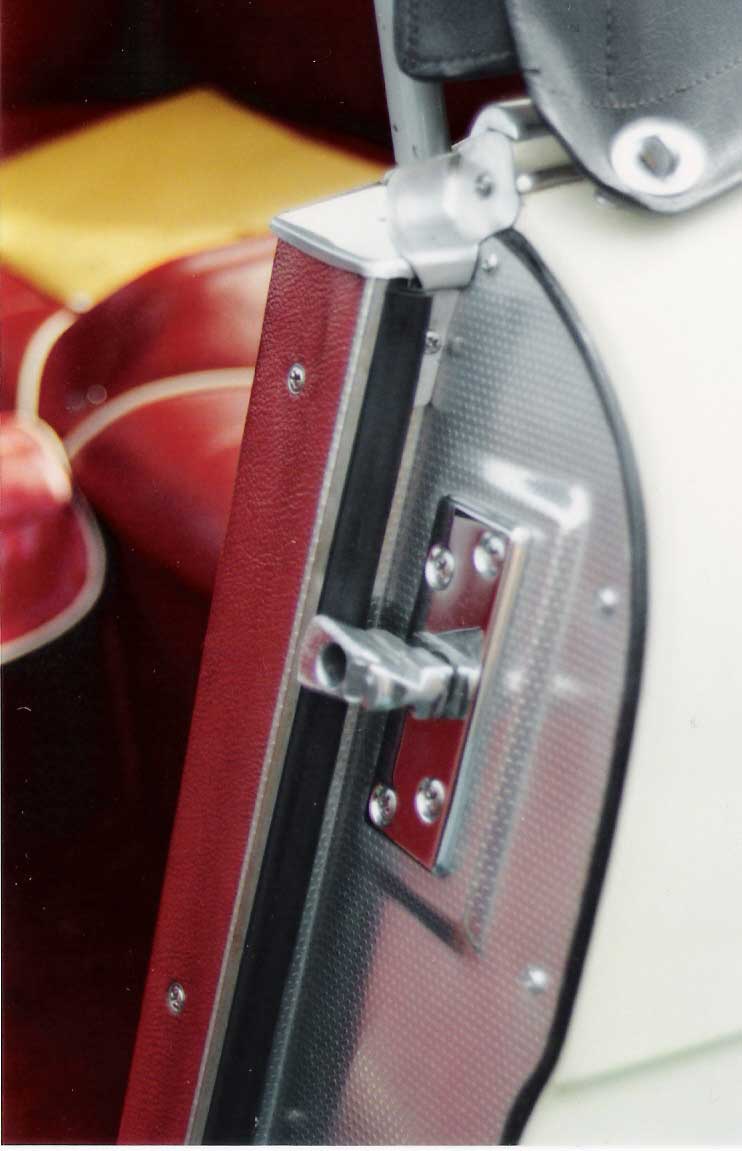

2)The beading I have is a very small diameter similar to image 1. I have seen other pics of a much larger beading image 2, and like it's look much more.
Any suggestions?

Up and over like your second picture which is a BJ7-8. The first picture is of an earlier car. I believe the original dia. is the smaller type.
Sorry, don't know where to find aluminum sheet in the original pattern except for KAS.
