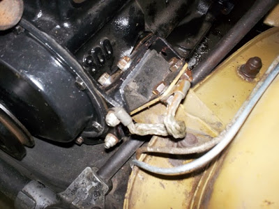

Is your engine grounded? That would be my first place too look. I also once had a similar issue where it was as simple as two reversed wres on the solenoid
How do I check if the engine's grounded?
There should be a braided or battery cable attached to the engine mount or somewhere along the bell housing or engine block, and then attached to the body. Something like this:
