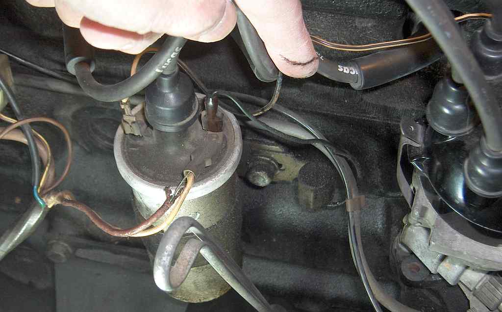

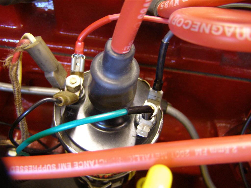

The balasted resister wire is not stranded wire as you can see in my picture. It is solid and easily broken. I've rewired mine and aded the external resister, but here's a before picture.

I have a '73 with a build date of Nov '72, comm no. CF 2761. It has the two wire circuit.
There was a significant change in the wiring between the 72 and 73 models, and that involved the removal of the ammeter in the '73 and later models. While on the surface, the replacement of the ammeter with a volt meter may not seem like a big deal, it in fact required a new design of the car's wiring harness. I do not see that an early version of the '73 harness would omit the two wire ignition coil design.
That said, it is a Triumph, and who knows what they did.
For information, the pink/white ballast wire is in the run circuit off the ignition switch. The white/yellow wire is not ballasted. It connects to the starter solenoid and provides full voltage to the coil on startup.

This is what the original wire looks like on a 74 (wires in sheath on left)
