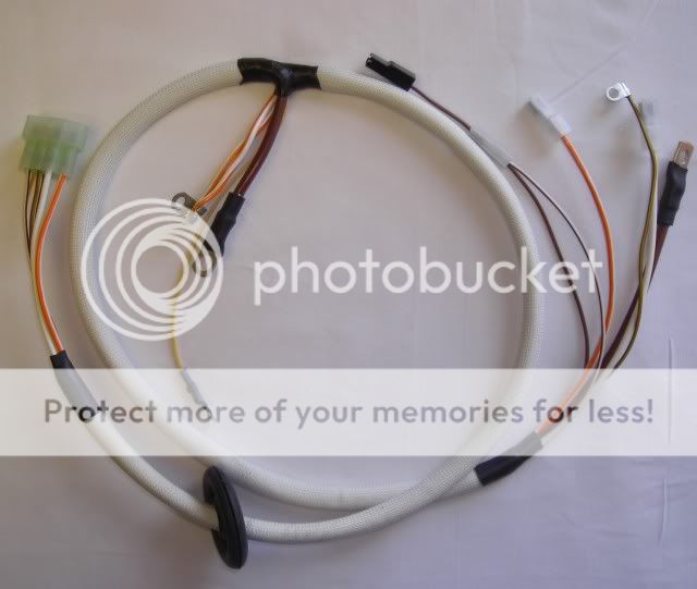

Not sure if the ones these people get are the same as the one I got for the Wedge alt/starter connection it is purdy
Ask Josh to send you a pic of it if he has one
