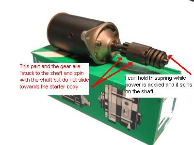

ok, one last thought before I headout. I can hold the spring which is outboard of the gear on the shaft when I apply power on the bench and it spins freely, while the gear does not spin. The shaft from the gear to the starter is smooth, no spiral anything. If the starter works correctly, the gear while spinning slides on this shaft in bound towards the starter, and engages the flywheel. Is this correct? Sorry for being such a dummy..

Keep everything clear of the gear/spring when bench testing the starter...and be sure the starter is firmly attached to a sturdy bench.
The initial "jolt" of the start kicks the gear down onto the flywheel, then the binding of the teeth keeps it engaged until the engine fire, at which time the gear is kicked back out.
Just clean it up well and lubricate it well and it should be fine.
It should slide up and down the sleeve by hand, oil helps.
Be sure to use a very light oil then after you get it moving I'd clean the oil off because the oil will attract dirt and it will get stuck all over again. You just need the oil to get things moving again until things "resurface" themselves, then clean it away.
