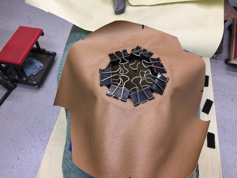

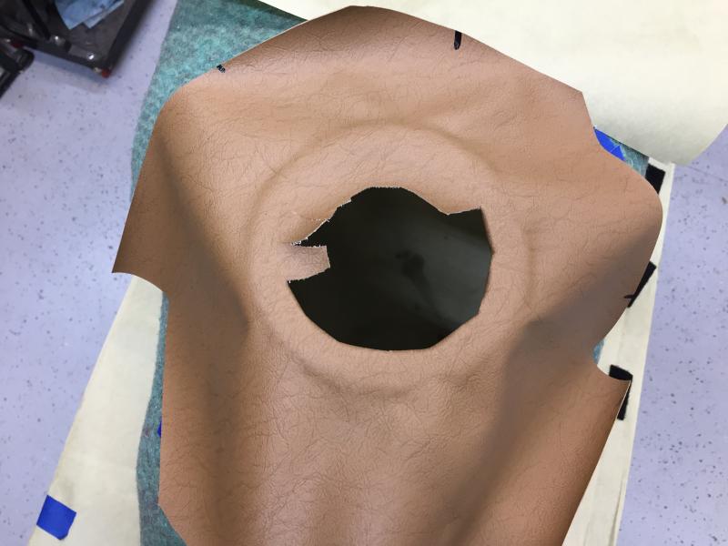

tried cutting the hole and the slits, then gluing the top. let it sit and then clamped it. but i could not get the sides down without wrinkles. tried everything i could think of.

first off the attempt at doing the top first.
cutting the slits.
clamped

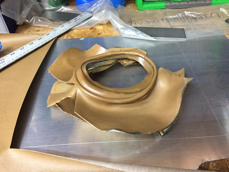

this is what i pulled off which is why i did not have a pattern. think mine looked better than this one anyway. it had open seams all over. guess the guy had no more of a clue than i did.
