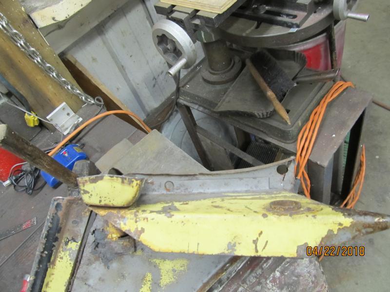

So, this leads me to my current dilemma. I still need to weld in the top/hood mounting hardware and I don't have any pictures/measurements so I am wondering if anyone has a car partially apart that can help me determine the correct location. Measuring vertically from the top of the sill I have approximately 16 3/4". (yes the sills are 3" above the frame)
When I compare with a picture of the shut pillar I cut out it looks like I will be too high - there is a fender mount bold hole that will be covered if I leave it like it is - hard to see but this last picture is of the shut pillar I removed (unfortunately I cant measure since it was cut off above the sill but I don't know how much above the sill) and you can see the hole that will be covered and the fact that the horizontal plate looks lower than what I have now. I'm fine with massaging to fit, but don't have a good way to determine what I need for a target.
Anybody done this? Anybody with ideas?
