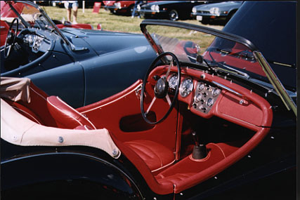

Many years ago, I met a chap from Williston, Vermont at Stowe "British Invasion" in 1995 had a blue TR3A with a blue interior almost the same colour and it had a very early Comm. No. for a TR3A. He had it repainted exactly as it had been earlier. He bought the TR from his uncle in Penn. who had bought it new so he was sure of the correct colour If you need more details, I might be able to search my records. I remember that he had found a place under the rear something or other where the sun had never faded the paint and the local paint shop had matched this perfectly. You can see a bit of it next to mine.

Thank you for the great picture of the Salvador blue TR3. Winchester and Salvador must be very close to the same. I was thinking that Salvador was a bit darker. A very rare color. When I removed the stone guard from one of my rear fenders I found some perfect original paint that looks just like the paint in your your picture. Salvadoe was discontinued in Sept. of 1956, my car was built in Dec of 56. I wish I could see the interior better. Again thanks for the picture.
Very early TR3A were painted Winchester Blue. From the picture the interior blue color is lighter than the exterior. That color combination does not look that bad. I purchased my car in the early stages of restoration. The exterior was in primer and the interior was done in what looked like something out of a boat. It was done to a nice standard but the color and texture was all wrong. I was able to find some of the original material under the dash but it was stained. I would love the see more pictures of that car but after 15 years I'm sure they would be hard to find. Thanks a ton for your help.

That salvador blue car pic I sent was used by the Moss Company in its TR3 catalogue. If you look on page A18 of the present cat you'll see the paint/color where they are advertising the badge bar.
I think they didn't change the colour. Thay only changed the name. Salvador sounds Spanish and Winchester definitely sound British. Marketing guys are like that.
