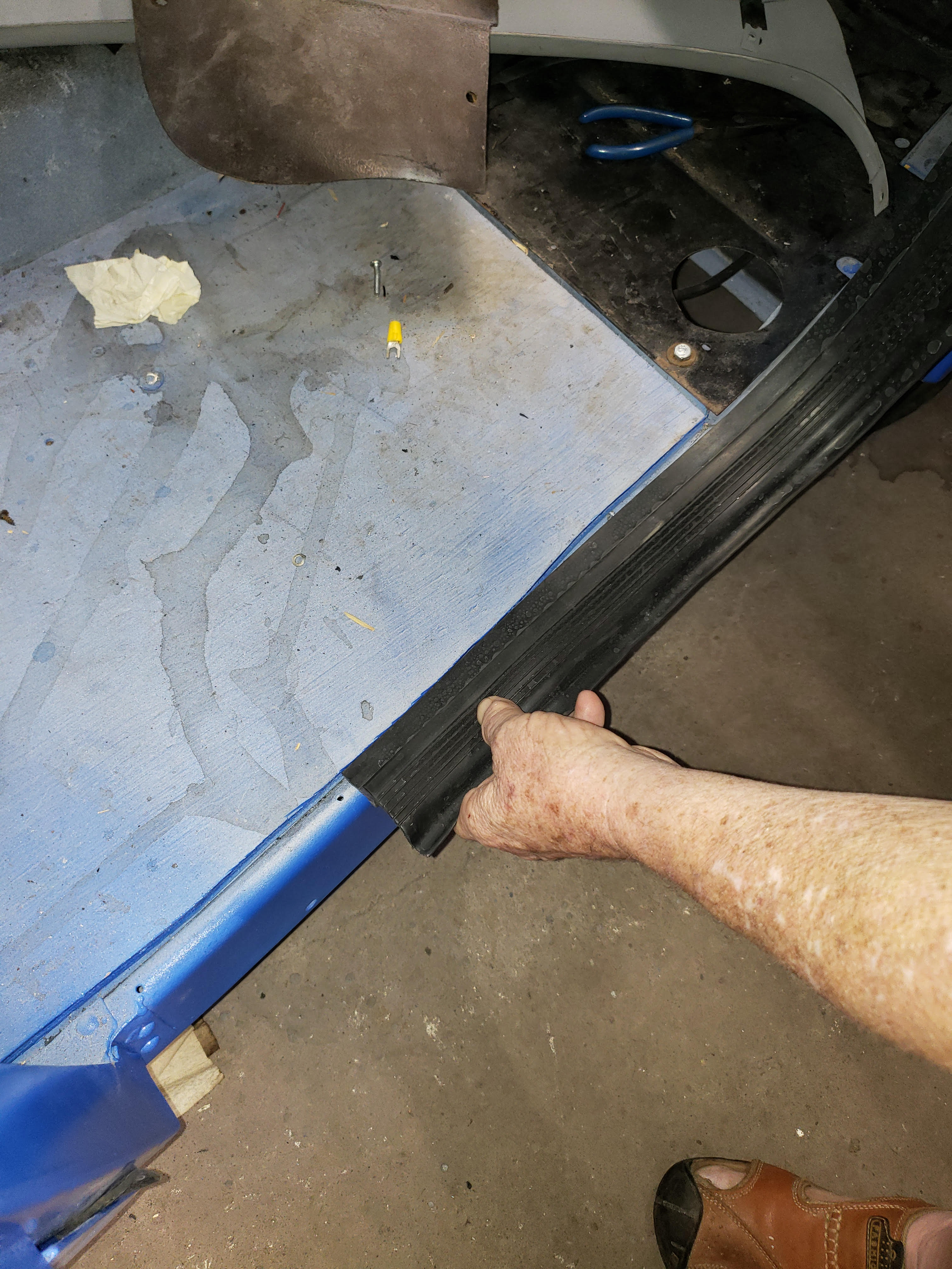

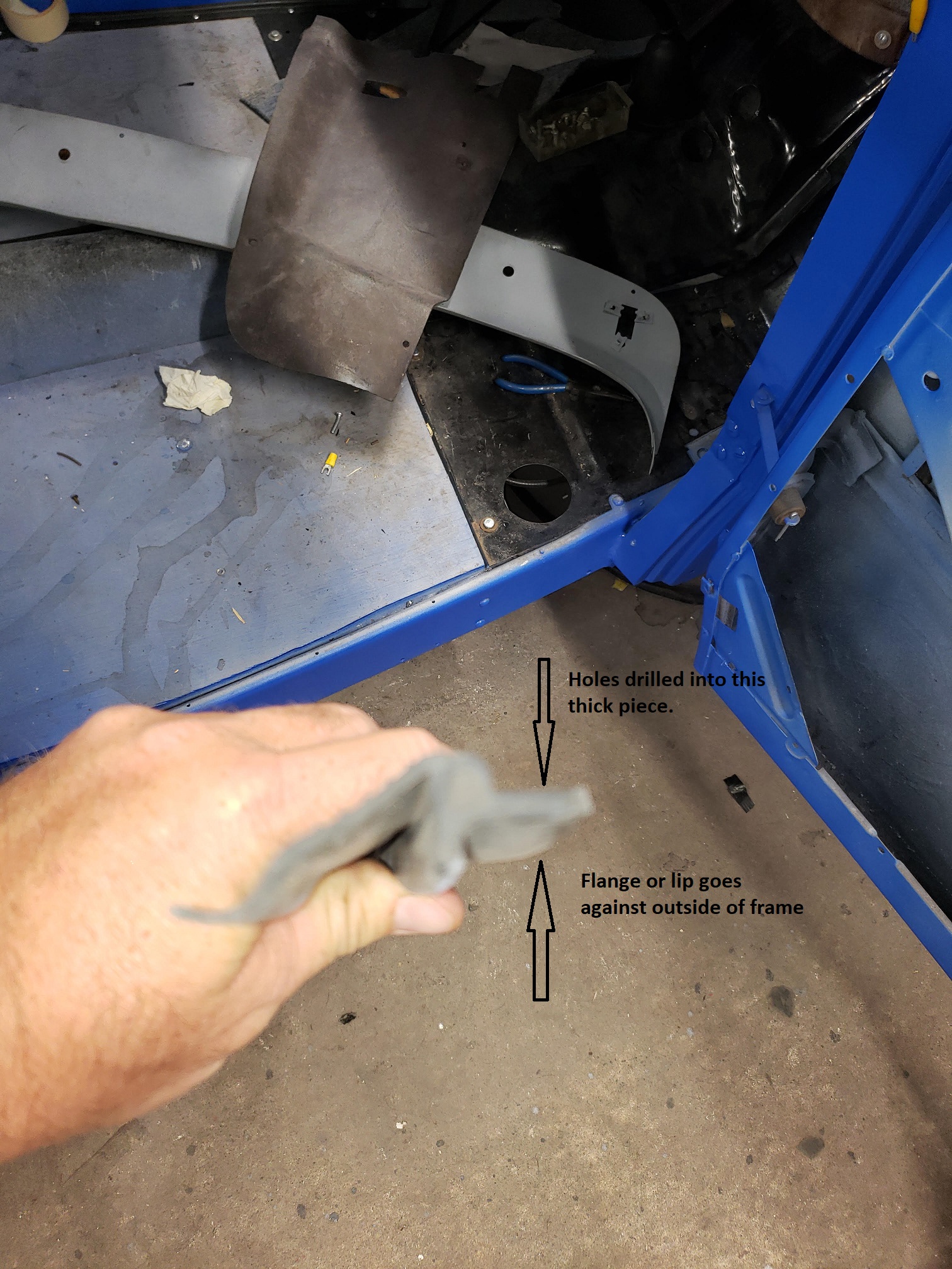

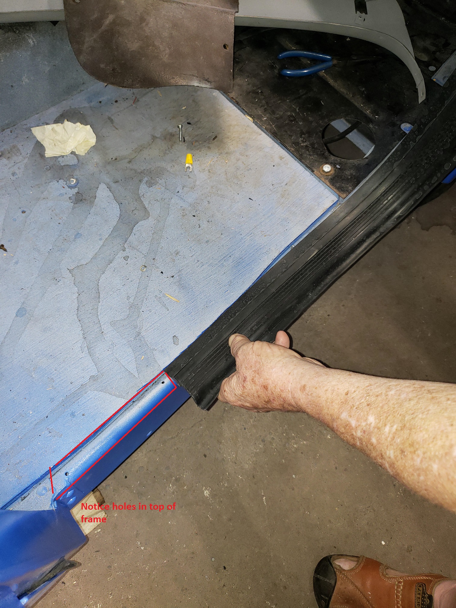

This pic shows the frame and the location of holes drilled at the factory on the underside of gasket is a lip that goes against the frame.
Thanks for the pic Jim. So do I understand right the rubber is attached to the frame instead of the door? Is it glued to the frame or what holds it.
If you look at the frame the very top you will see a line of holes it is screwed on the under side of the gasket is a lip and that goes against the frame. the door goes against the gasket.
Here you go hope you can figure it out I am a truck driver not an educator :smile:

Wow! Educator or not, I think you have done a quite creditable job of educating there. I have the rubbers put away but even without seeing them directly, I think I understand now. Thanks again.
