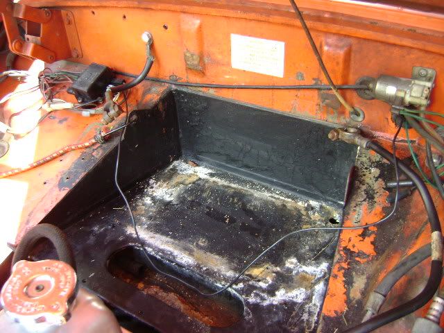

First things first, disconnect the battery. I painted this last year, but the battery acid has done its work. I'll redo it with POR, topcoat it and add a battery 'blanket' to avoid having to do it again.

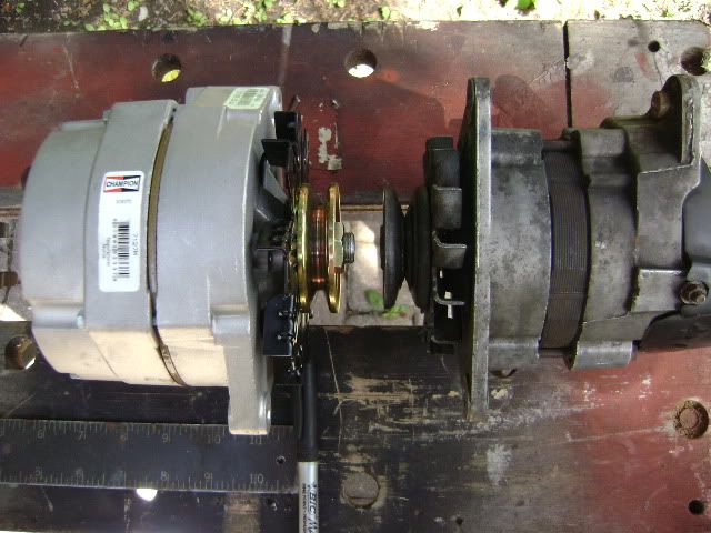

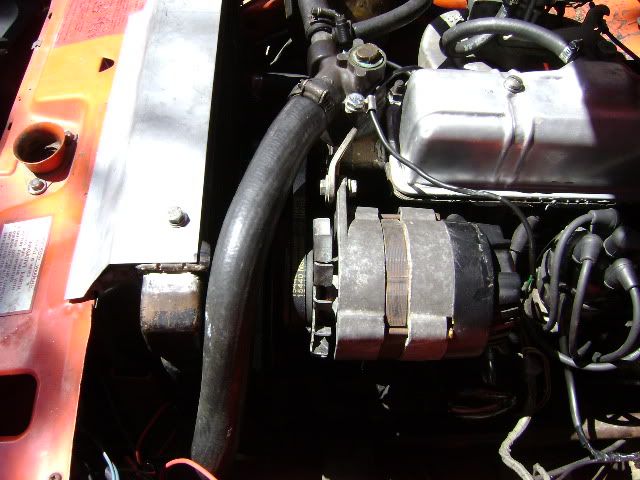

Here's the crappy old Lucas. 30-something amps when new, definitely not up to the task. Out it comes.
And here it sits next to its replacement. I went to my local parts place, and (true to form) they weren't able, at first, to find anything using 7127 (-9, or anything else.) "Fine" says I, "I have a... umm... 1974 Chevy Nova, 350, no A/C." Parts Guy calls it up on his trusty computer. "Alternator" it says, "7127-9". Parts Guy looks sheepish, and wanders off to find same.
There are many brands, all with slight variations. This one, a Champion rebuild, is 65A, and cost about $100 with the core charge.

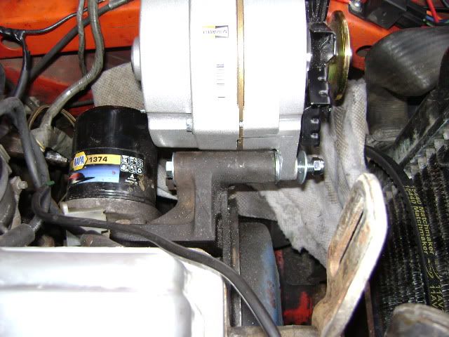

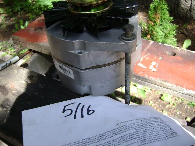

The 7129 has two mounting 'ears' - a thin one, threaded, and a thick one, not threaded. I ended up using the thin one as my bottom mount, and the thick one as my top mount.

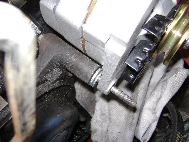

Now, here comes probably the biggest difference between the Spit 1500 and Midget. Where Paul's page shows a spacer at the lower mount, my 1500 had the alternator mount (attached to the block) with a long solid tube, no spacer.
First, I drilled the threaded hole of the thin mount out to 5/16ths, the thickness of both the mount bolts.
Paul's page mentions shaving down the thin ear slightly, and I did, but with the thicker alternator mount, it's not possible to line up all three pulleys just by shaving the alt. It's too far out (forward). The important distance is centre of pulley to rear of mounting tab, and I think the two were about 3/8 different.
What I did in the end, and what I would suggest anyone else do *instead* of modifying their alternator, is take a zip disk on your angle grinder, and take off maybe 3/8" or 1/2" off the front of the lower mount. Take off slightly too much, and then shim with washers; it's easier than trying to shave off 'just enough'. the mount is still long enough that there is little to no wobble. That's what I ended up doing, but with and eighth or two off the ear as well.
The bolts I'm using are all 5/16ths, but my local hardware store didn't have long bolts in UNF, so the lower bolt is coarse thread. Lower bolt has a nylock nut, since it has to be left just a tiny bit looser (to allow movement). I need to either find a 1/4" shorter bolt, or hack some off this one, as it *just* touches the drive belt when installed.

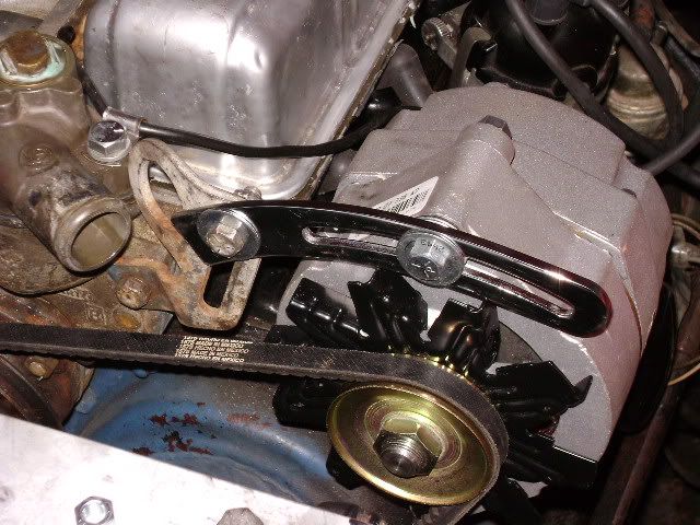

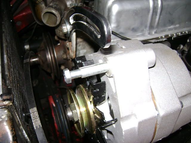

The top was almost easier. As with Paul's site, I hammered a piece of scrap sheet metal around a 5/16ths bolt, to make a spring pin, which I knocked into the upper mounting ear. Fit great first time.
I kept the original alt bracket in place, and turned it up all the way to remove any play. My NAPA store had only one alt bracket in stock, and thankfully it fit beautifully. Drilled a 5/16ths hole in it after test-fitting. Attached it to the existing bracket, and it stood about 3/16ths proud of the alternator, which was taken up by a couple of fender washers.

So there it sits. Took a good few hours, factoring in extra runs to the store, and the occasional libation. The battery tray is covered in POR15 as we speak, so it will have to wait until tomorrow before I can confirm whether all is well.

Most cars have three mounting points for the generator. Even the Delco uses three mounting points, though only two bolts. On your installation, the long mounting flange is only attatched at the front end. Therefore only two mounting points. This is usually fine for a starter, which mounts onto a large flange, but the generator is free to vibrate. And excessive vibration can break one of the mounts (the smaller one probably).
What I propose to suggest is a brace at the rear of the generator to the block or head to help prevent vibrations. I know it would be a real pain to install, but you really wouldn't want your new very nice looking generator to break the lower flange off.
