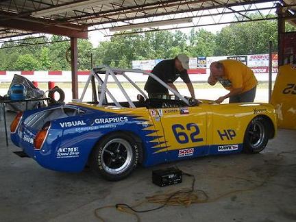

With 3.5" back spacing and Spridgetech glas on the car you will need to opt for the the longer 7/6 comp wheel studs, and about 1/2" of spacer. Here a Picture of a Midget with then rule required 5.5" wheel and wheel spacers and the Spridgetech fender, we built a few year back. You going to more than likely need some offset springs to accomodate those wide wheels as well.
