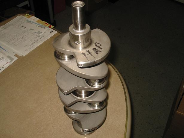

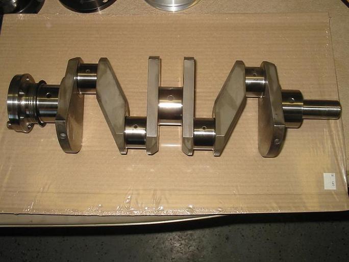

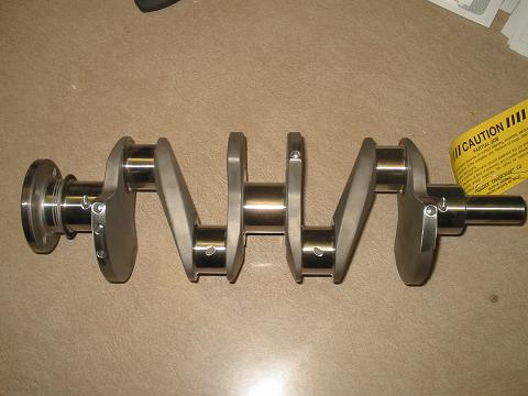

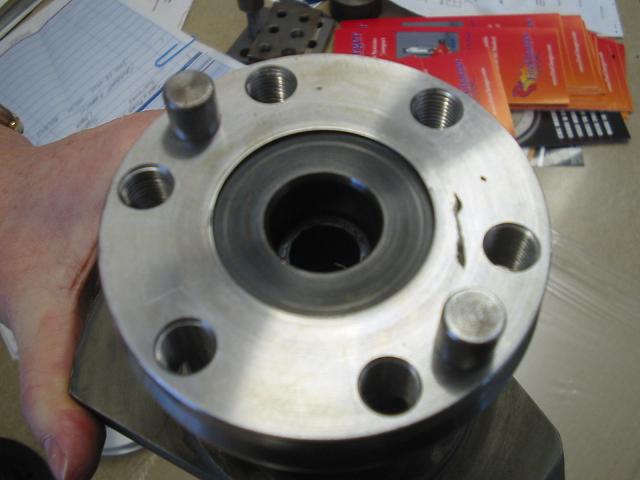

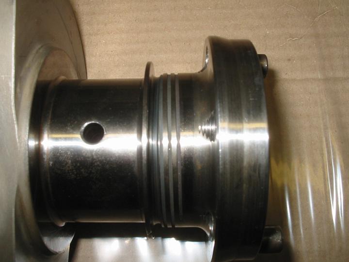

Nial, it got a serious scattersheild. It was a wild job even for me, then only reason I ever considered it, was for the dirt track engine builder who literaly had did this dozens of times. Believe me I had my doubts, in the end it was the customer's choice with all liabilty lying on him, but so far it's worked out fine. It's fairly an elaborate process, the crank has to be brought up to temp, then 4130 weld applied, but only a little bit at a time, it probably weat through the cycle a dozen times, the the machinist had to mahine it to exactly mock the original flywheel hub. This engine won the Walter Mitty this year, both the enduro and the sprint race. Overall this de-stroked engine makes very little sense, but I kept it together for the customer, just an example of the wild stuff floating around at a HSR race, 1380/5 speed cars are quite common there, that's why I'm looking forward to busting their butts with a .040" over 4 speed car /bcforum/images/%%GRAEMLIN_URL%%/smile.gif

That crank was evidently done right at the onset....with the two dowel pins as shown in the recreation. Huge amount of second harmonics....maybe the bolts loosened up or failed??

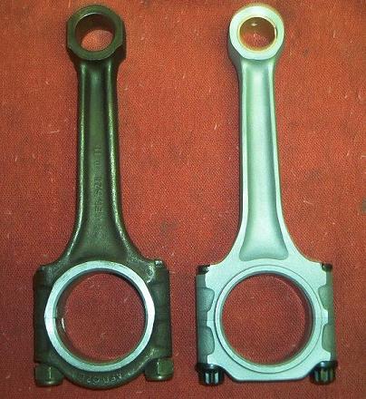

Jeff, as for the rods weight, still heavier than the Carrillos, but we can't use them in SCCA LP anyway, The stock 1275 rods start out out roughly 685 grams per rod, and we gotten mostly 100 grams of them, it all depends on the cores, the heaviest ones still weight about 600 grams when done.
Jerry, yes the last EN40B crank I had was still std./std, straight, mag checked and polish and a guy paid me $600 for it, and I let him have it /bcforum/images/%%GRAEMLIN_URL%%/smile.gif A customer at the runoff this year gave me a tote full of 1275 cores for future engine projects, and he has 3 EN40Bs in there. On the retianer we had them made by a racing buddy in the Charlotte area, but I might look you up if I need some more. I buy oversized valve spring for the vintage and F-prod 1275, and use alloy retianers, I got a good source on them as well I would share with you, he like to sell some volume, he offer both the alloy retianer and a steel retainer, you have to enlarge the spring pocket, but I have a buddy who lets me bottow his tool for that, do on the mill, real easy job.
