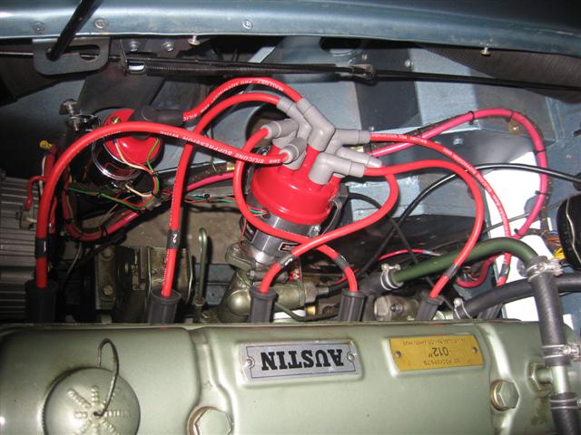

It's interesting that the 1-2-3 installation instructions recommend using resistor wire whereas Mallory suggests using solid-core wire for all electronic ignitions. BTW I bought the Mallory wire which matches nicely the red cap. See attached photo.
Best--Michael Oritt
