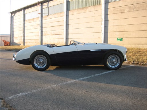

I made my first trip with my new 100 today. The car pulls strongly and does not miss a beat. The only thing is that after turning the ignition off the engine does not stop instantly but misfires heavily for some seconds. I am using fresh unleaded premium petrol with lead additive and new NGK BP6ES sparks. The engine has full Le Mans spec with high compression pistons. Does anybody know how to solve this problem???
Thank you for your answers, Wolfgang
