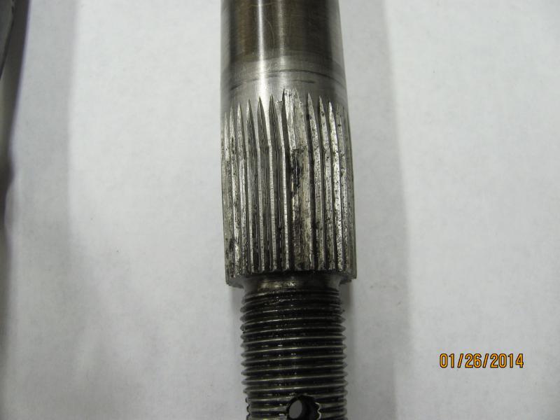

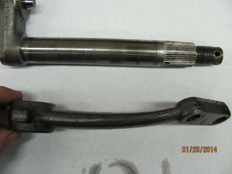

Derek is correct - it's only possible to install the rocker arm in one of four positions. I wrecked mine in a racing shunt a couple of years ago and quickly saw the bent rocker arm. Upon disassembly the twisted rocker shaft was a great surprise to me considering the size of the shaft. I doubt I would have seen the twist if not fully removed from the box. Imported Photos 00001.jpgImported Photos 00005.jpg
