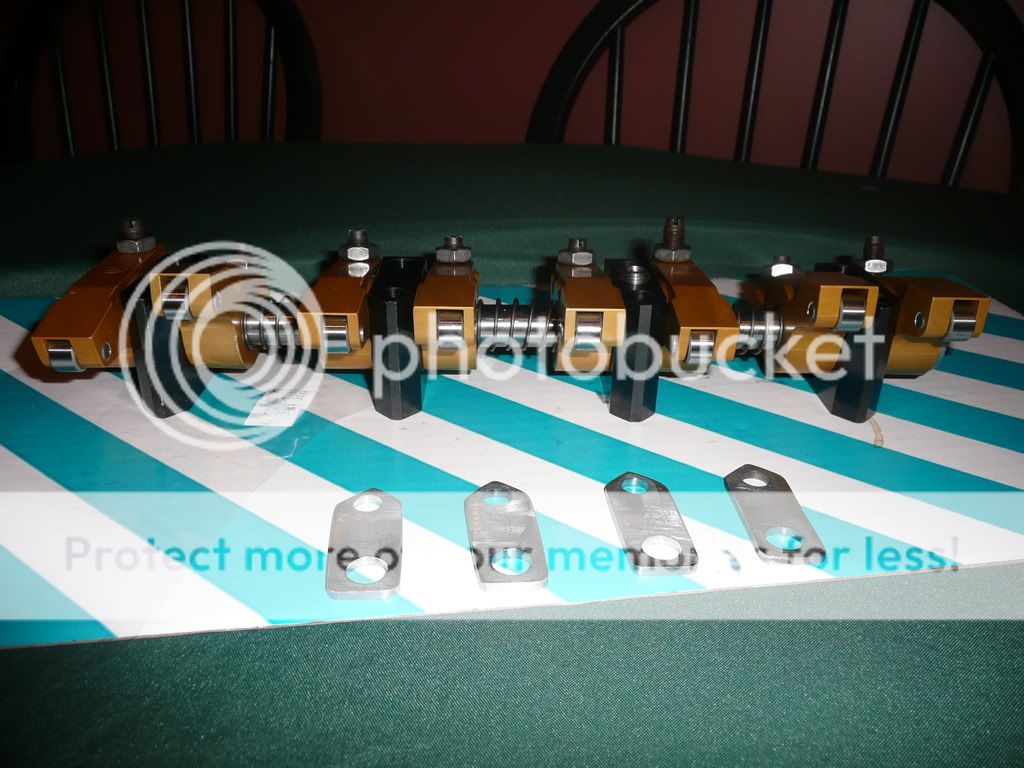

Hello, I just built a 1275 , bored out to 1363, purchased a high lift kit from Swiftune in the UK. Comes with 1.5 roller rockers, valve springs, cam SW5 and oil pump. The rockers are beautiful, they seem to work ok, but I have nothing to compare them to. You will need shims under each rocker post, I made my own, forgot to buy them, otherwise the rockers will not adjust, the pushrods are to long so that is why we shim them. Shims come in many sizes, give your rocker guy a call if you need them. I had a sick 1098 before, and only 300 miles on my new engine. In a few months I think the truth will come out. I am running a stock head, waiting for my ported head, Hap is building, should have it in a couple of weeks. I had know valve clearance problems, but I am no expert,(evo 73mm pistons from minispares 10:1 comp.) not sure of your setup. Hope I helped.
Cheers Phil

Hi Devin,
I am not sure if you need shims, from my research I needed them, give minisport a call. If you install your rockers you will see the problem,(if shims requird) the adjusting nuts will be full out and the push rod will still be to long. I was not aware of the shims and it slowed me down.
It was fun building my engine but I am not a expert, just wanted to save you some grief with a heads up. I really love the look of the rollers, they look fast and when I open the hood I know there just underneath my alum valve cover. IMO I would install them now, easier to adjust on the bench.
