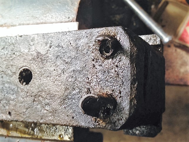

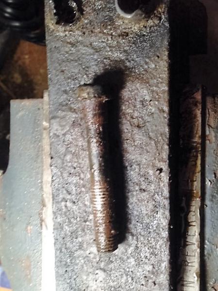

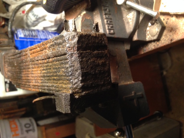

One of Bugsy II's 1/4 Ell 2015 26 15 Spring IMG_1233.jpg2015 26 15 Spring IMG_1235.jpg2015 12 26  Spring IMG_1232.JPG2015 26 15 Spring IMG_1237.jpgiptics came out without a struggle from the Spring Box, everything is clean as a whistle. The PS on the other hand is a pig that I needed to drill out to extricate. I marinated in Evaporust for the past 4 days and pulled it out and placed in my trusty vice. A couple of sharp blows with my 5 lb sledge and a punch allowed me to remove/punch out the centering bolt fairly easily. Now I need to remove the two rear Spring Bolts. I needed to drill out the centers to remove the head of the bolt. Now I need some advice as how to get these the rest of the way apart and save the spring. The springs are usable and can be cleaned up if I can get this basta_d apart. Advice guys.
Have Drill press with machinist vice and could drill out but I fear I could end up drilling off center as I get through the stack. Other thought was getting the other end apart and somehow wedging spring apart from the two bolts that are rusted in place. Need some cogitation on next steps. Here are a few pics.
If I get my Dremel with a cutting Blade under the Spring Plate can I cut it and then Drive out the bolts after some more marinating in EvapoRust? Thinking that may be my next step.

Use your angle grinder or sawzall to cut the head off and drive it thru. I sand blasted mine and primed with self etching primer followed by Slipplate. If I had to do it again I'd just blast and paint with Slipplate and go with the dark grey look. It preserves the springs and lubricates them so they won't squeak...since its dry it doesn't attract dirt and grit.

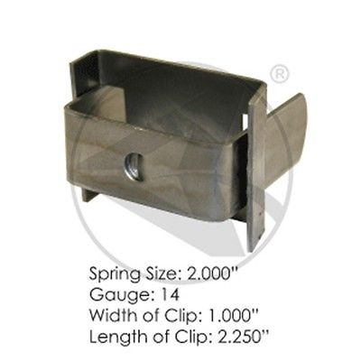

Guys would something like this work for 1/4 Elliptics. I see two types of clamps which could replace the clamps that are on the spring presently. These come in 1 3/4" and 2" widths/ Spring appears to measure 1 7/8" so guessing a 2" clip would work or do I need to go to some sort of U Bolt Setup. I see two different types, those with a flat plate and nuts and those with a Horizontal Bolt that runs under the spring holding the sides together. Leaf Spring Clip Strap s-l400.jpg

As far as using a u-bolt to replace the straps, it somehow needs to be fastened to the leaf spring, otherwise it will just slip off toward the rear. The spring clip you are showing is only 14 gauge--I am not sure that is thick enough.
Are your original straps badly rusted? If not I would just clean and reuse them. They are still fastened to the leaves, correct?

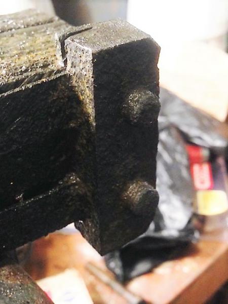

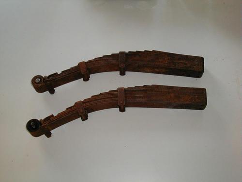

2016 01 01 IMG_2625.jpg2016 01 01 IMG_2627.jpgA couple of more days for Spring in Evaporust. I used the angle grinder to cut the top of the Spring Plate Bolt off and flush with the top Spring mounting plate. With Spring firmly in vise. I was able to use a cold chisel and a 5 lb sledge against the lip that sticks out around the side of the top spring plate. A couple of good smacks on each side to keep things moving evenly and the spring plate began to move. Leaves began to separate as the bolts for the spring plate began to move past the leaves 1/4", 1/2", keep pounding, 1" and all of a sudden all the leaves were free. Yeah. Other spring is in Evaporust now to free up the centering bolt, a project for tomorrow morning.

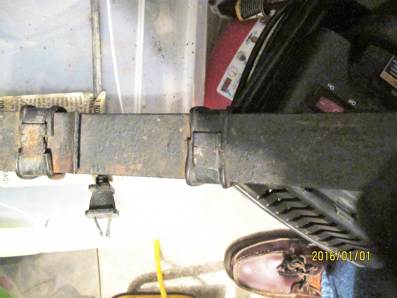

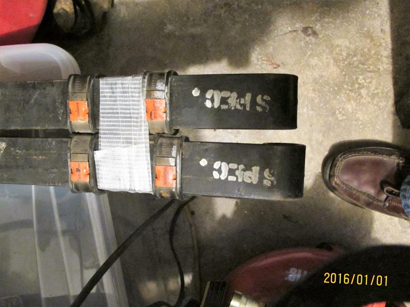

This question was asked - "Are your original straps badly rusted? If not I would just clean and reuse them. They are still fastened to the leaves, correct?" In the two pics you can see the straps I am referring to. First Set Pic is of Spring I just took apart, 2nd pic is a set of 10 leaf Springs I acquired for a very good price but I don't want to use if I can find Clamps/Straps that hold the spring leaves together in the middle. Would a real Spring Shop have these type of banding clamps. Plan is to call Dayton Spring tomorrow if they are open and drop by to show them what I am looking for. If they sell or can restrap for a few bucks after painting and cleanup I'm good.
Next step get the other one apart after driving out the centering bolt. Use the heat wrench to remove/burn out the rear bushing, wire wheel everywhere, anti rust / POR-15, paint leaves with SlipPlate, reassemble with new straps, nuts, clean up U Bolts and see if they are salvageable, new set of Straps from Strapping Lab and new bumpers, bushings for Radius Arms.

Ok--here's the confusion. The clamps that you have pictured don't look like mine. Mine have a U-shaped piece of strap iron, maybe 3/16" by 1", that is riveted to the top leaf. The legs of the U run down the sides of the spring pack and are fastened together around the bottom leaf with a bolt. That bolt runs through a bushing that is simply a round tube that seems to have been formed out of sheet metal. I wish I had a photo--it must be on my computer at work.
So, I don't have an answer to your question--they must have changed the design at some point. Maybe someone else can help!
If you look at the pictures in MOSScatalog the original design is just as you described. Yes design was indeed changed. OK that resolves my confusion. Thinking if I take to a real spring shop they may be able to help. Looking on line I do see some design for spring retainers/clamps but they are not the correct width. It may be possible to fabricate a strap in the correct width but as someone commented the stuff I see commercially available is may from 14ga steel and may not be heavy enough. I'll keep looking and check out the Spring shop as well.thanks.
I wish I had a better picture than this, but I hope it helps.
